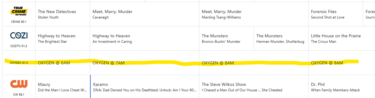

I have recently switched from an hdhomerun prime to an OTA model. mostly working fine for guide data, but I notice that at least one channel is missing data for the programming. the channel is 51.3 in the Rhode Island area (oxygen). I checked the guide data on the channelmaster website to see if they have anything listed and they do. I am not sure where to start troubleshooting this except that I have removed and readded the guide data.

It looks like it is not showing up on zap2it either.
The developers in these cases recommend reporting it to zap2it.
Link to Zap2it
Not sure who the channelmaster site uses for guide data, but Channels uses Gracenote guide data.
You can check it at https://tvlistings.zap2it.com/
Thanks to you both for the reply. I will file a report and see what comes of it.
Thanks again
If you have a SiliconDust HDHR tuner, you can also report it to them here Guide Issues - Silicondust
