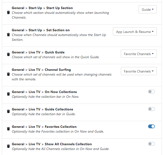

Here's that section of the client settings. I just noticed the verbiage now of 'General > Live TV > Favorites Collection' says 'Optionally hide the Favorites collection in On Now and Guide' but I am reading that as On = Show Favorites and Off = Hide Favorites, and since that is what is happening on the FireTV's, and the toggled off options aren't showing, that would seem to be correct?
The way I understand it is all those settings (except the on now setting) pertain to the drop down box in the guide.
Guide collections toggled off would hide the dropdown which I assume is what you want. But I've also had it get stuck chosen on the wrong selection and I had to turn it back on to put it back to all, or in your case favorites, since you only want to show the favorites. So this may seem like going backwards but try toggling the guide collections back on to reveal the drop down, make sure it's selected on favorites, then toggle the guide collections back off
