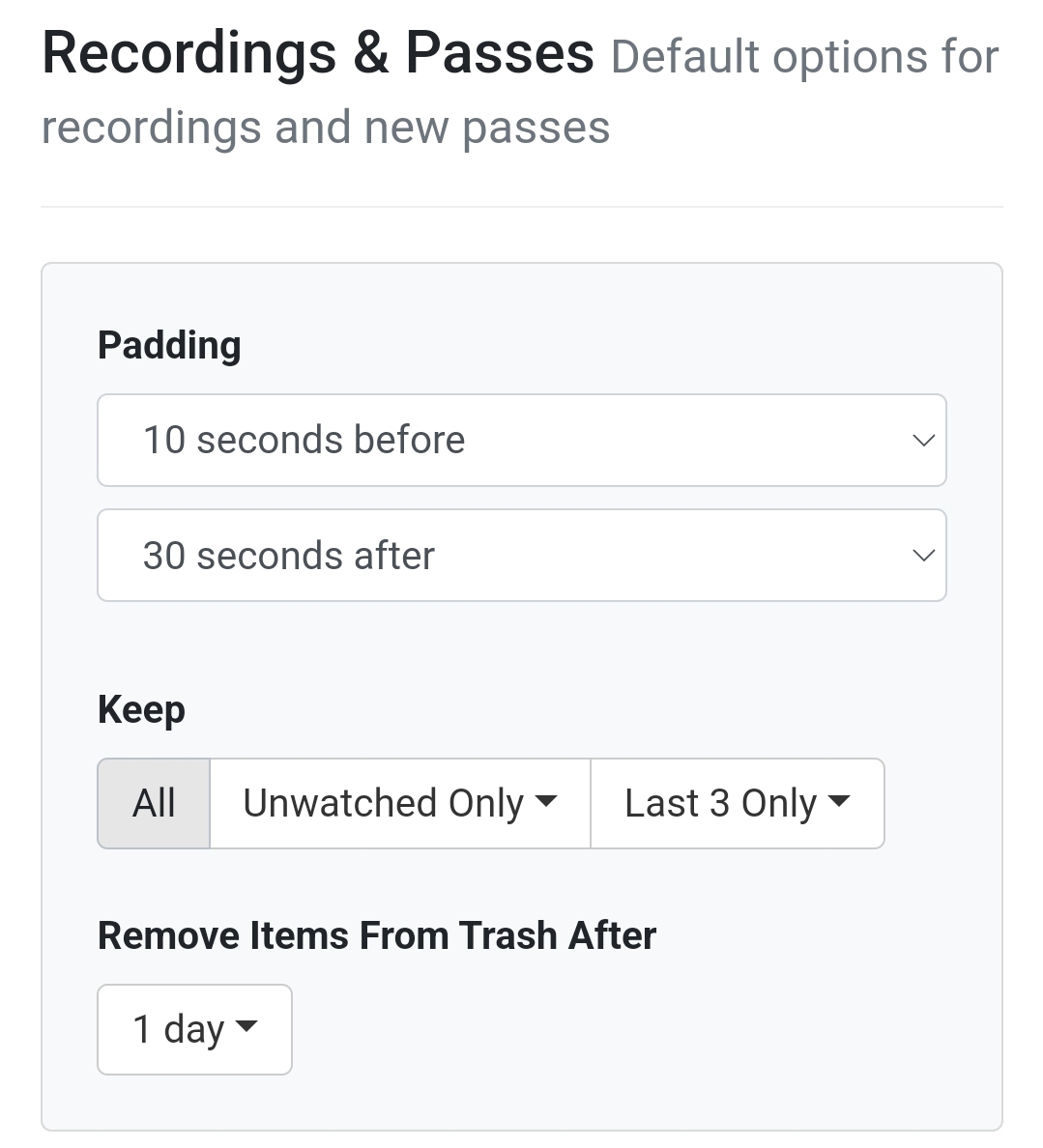

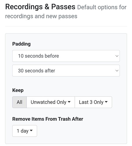

Any pointers on the recordings stopping just short of show completion , seems to be a trend. Does this have something to do with the transcoding delay on the tablo perhaps in combination with sometimes recording on all four tuners simultaneously. I am not running out of cycles or ram, because i have found it recording 8 things at one time with TVE as well , I am not seeing any issues with frames or dropped recordings, but i realize that is a lot of 1s and 0s being written to the drive at the same time. I don't think its a padding issue but it could be I guess.
In my setup padding is set to 5 minutes after in "recordings & passes". It will eat up a tiny bit more space but not seeing cutoff shows for years on end now.

Since your NAS (DVR Server) time is accurate, it's most likely the network is running programming later than the schedule shows it. Looking at the timestamps in the DVR log will tell you when the recording ended and then you can determine what end padding you might need to add for those shows.

It's probably the network going over. It happens to me all the time. You can change your default pass timings so that evert recording has a buffer.
