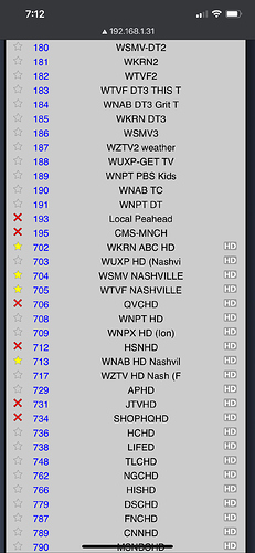

Thanks! Spectrum told me over and over that my lineup won't see DRM. We think it's because my package is a-la-carte. I only see what I subscribe to. I don't even see other channels that only show a black screen. I don't see them in my subscription list at all. Plus with only 15 channels. What is the point of DRM. BUT, if they do DRM I have TVE setup too for recording. This is a stopgap for ABC and a few other OTA ones I couldn't get otherwise. My Channels lineup looks crazy anyway. I have like 5 CBS's. 2 ABC's, etc...
These 15 are about 80% my mothers. So I keep to the news, and locals.
