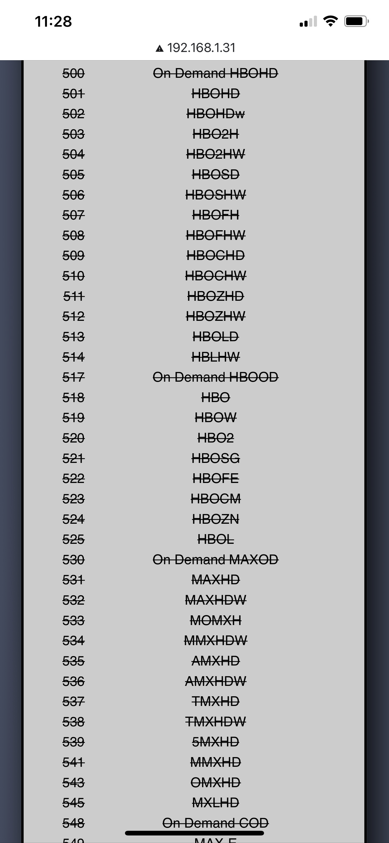

Here's a tip.
When you view the HDHR Channel lineup from its web UI add ?show=all to the end of the URL.
http://192.168.1.31/lineup.html?show=all
The channels with a line through them are the ones the Prime can't tune in.
So either you're not subscribed, or it needs the T/A to tune them.

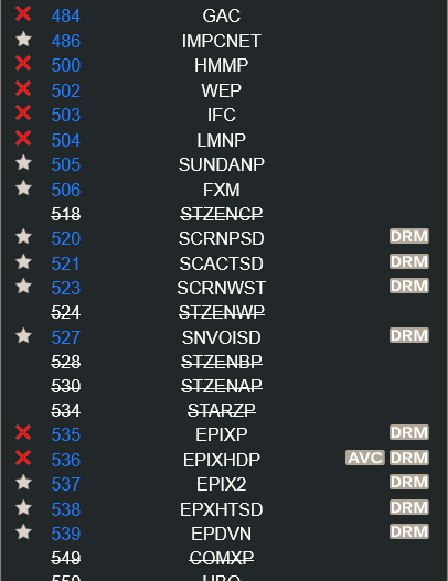

Wow. Thanks for the tip. I didn’t know I could do/see that. There’s some locals behind the TA. So I’ll need it to watch those. Or use Antenna.What’s crazy the ones blocked out, even the ones that I would expect to show DRM, don’t. I guess those need a TA to even show DRM status.
Sometimes after activating a new cablecard install it can take up to a day for the DRM to show up.
They will.
The ones with lines through them can't be tuned by the Prime, so it doesn't know if they're DRM or not.
In my screen capture above, all the Starz channels are DRM, but the ones with lines through them aren't in my lineup and can't be tuned. Like 524.

The Prime won't know if it's DRM until it can tune the channel during its scan.
Try watching the channels you think should have DRM and see if they play.
How do I do that? Those channels are Marked out. I ONLY see those I am subscribed to. I do have some marked out that I DO subscribe to. I am sure the TA is needed for those.
Oh. If they have a line though them you cannot play them because the Prime can't tune them.
