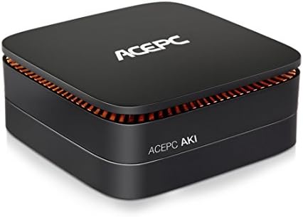

Iâm using an Acepc also with an external drive attached. Works great and very quiet. Only problem is I canât get the newest windows update due to limited 32GB eMMC. Just something to be aware of. Gave up on adding a SSD for now. I was having problems. Will try again when I have time to tinker.

Yes that is a limitation, but I just install most of my programs to the attached drive and leave as much room as possible to the built in drive. Plenty of room for Windows updates, perhaps delete other update installations that would be using up your space there?
I donât use this pc except for Channels, and very very light internet use.
