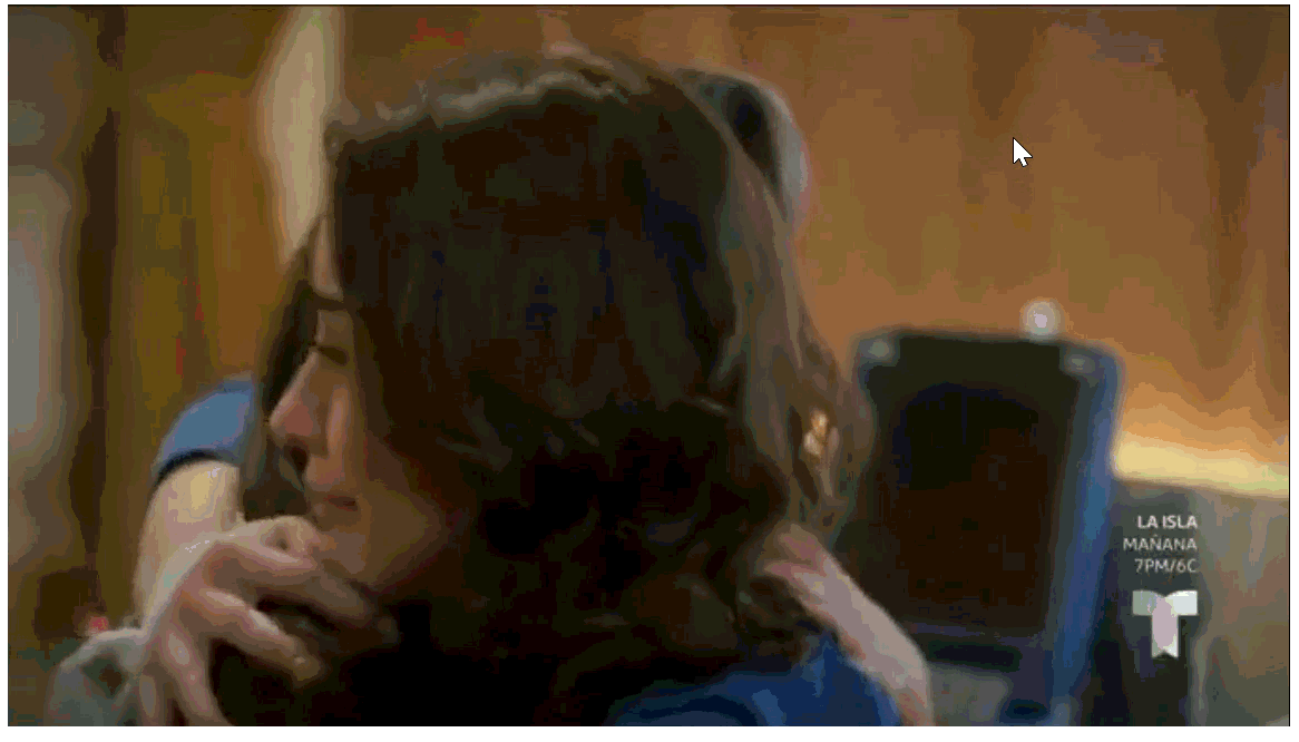

Thanks for asking. That has not changed. I'm pulling from the fancybits repo and running on my M1 Mac mini.
Sometimes i have stream running for hours with no issues.
Yesterday it did it 3 minutes in, to the recording. recorded the play button for 31 minutes.
I watch the stream on my firestick, what i have ended up doing is when i notice it happens i run to my computer and connect to container using vnc and start the player manually and it starts playing again.
snippet is from the recording at the 3min mark:
snippet
Sounds like the stream is getting interrupted. What are the specs on your Docker host computer? What OS are you running on the host? What's you Internet connection like? Is there a VPN involved?
EDIT: I just had it happen to me after around 4 hours. This is the first time I'm using NBC via cc4c, are you seeing this with other sites too?
That's the channel i mostly use with cc4c, but i have not had this issue on other sites.
From what i see in the recording the whole page does not refresh just the video frame, so it will not run the functions on: cc4c github - nbc code because the whole page did not refresh.
Is it possible to add a timer that would check every x amount of seconds if video is paused.

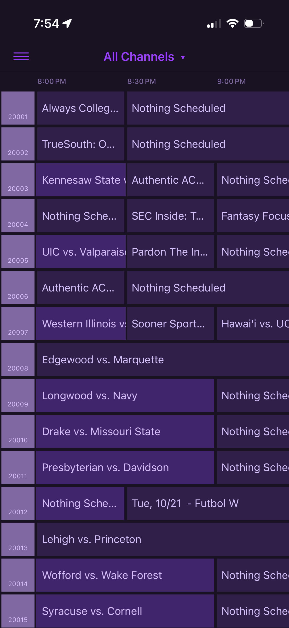

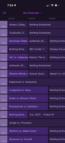

Since ESPN+ went DRM, I’ve been working on a way to integrate ESPN+ into Chrome Capture channels. I went a little overboard and devised a way to make “virtual channels” with their lineup. The program grabs the live/upcoming events from their API makes up a schedule and makes XML and M3U and puts into Channels.
It’s still pretty raw but been fun to work on.
Any chance you'll share? I may be able to Macgyver that for ah4c or adbtuner
I'd be down to test. I haven't used cc4c in a while though with all the issues with chrome updates and such. Does this work in windows still? Or just docker?
Sure - it's quite hobbled together right now, but thats my intention to get it out for anyone to test it. And I'm in way over my head so hopefully someone smarter would get interested in it too :smile:
It’s all python based with a small SQLite DB that stores the API scrape. So I think it should work with windows but honestly not sure.
I think a container is probably the route I’ll take.
The one major thing I have to figure out is full screen. I made some changes to CC4C main.js to get CC4C to send a “F” key to trick ESPN player to go full screen but it’s not consistent just yet. I’ll get there …
I meant cc4c lol. I used to run the main.js directly on windows. But I'm not sure that still works does it?
Very cool. I was thinking something similar but having it call my HDMI for Channels setup with the event id to direct tune.
Will be watching as it evolves and hope you will share. The upcoming multi-view will be much better if I can get espn+ back.
