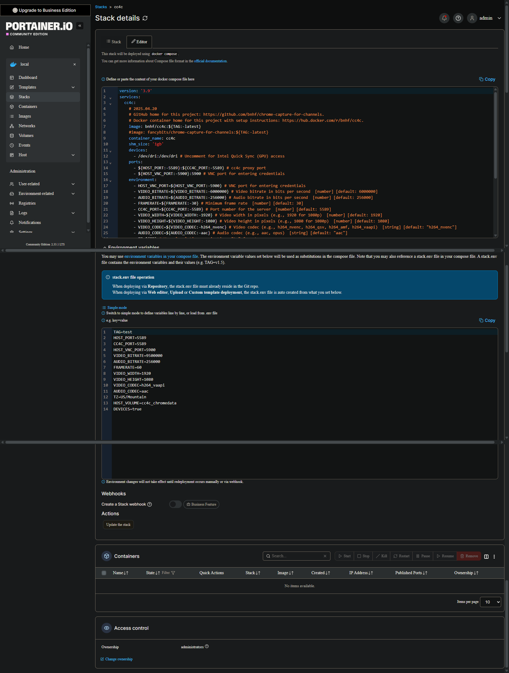

OK, let's try this again. The above is not the way I'm asking you to do this. In the Portainer-Stacks Editor, enter this Docker Compose exactly (and do NOT edit it in any way). Also, I've made one minor change:
services:
  cc4c:
    # 2025.04.20
    # GitHub home for this project: https://github.com/bnhf/chrome-capture-for-channels.
    # Docker container home for this project with setup instructions: https://hub.docker.com/r/bnhf/cc4c.
    image: bnhf/cc4c:${TAG:-latest}
    container_name: cc4c
    shm_size: '1gb'
    devices:
      - /dev/dri:/dev/dri # Uncomment for Intel Quick Sync (GPU) access
    ports:
      - ${HOST_PORT:-5589}:${CC4C_PORT:-5589} # cc4c proxy port
      - ${HOST_VNC_PORT:-5900}:5900 # VNC port for entering credentials
    environment:
      - HOST_VNC_PORT=${HOST_VNC_PORT:-5900} # VNC port for entering credentials
      - VIDEO_BITRATE=${VIDEO_BITRATE:-6000000} # Video bitrate in bits per second  [number] [default: 6000000]
      - AUDIO_BITRATE=${AUDIO_BITRATE:-256000} # Audio bitrate in bits per second  [number] [default: 256000]
      - FRAMERATE=${FRAMERATE:-30} # Minimum frame rate  [number] [default: 30]
      - CC4C_PORT=${CC4C_PORT:-5589} # Port number for the server  [number] [default: 5589]
      - VIDEO_WIDTH=${VIDEO_WIDTH:-1920} # Video width in pixels (e.g., 1920 for 1080p)  [number] [default: 1920]
      - VIDEO_HEIGHT=${VIDEO_HEIGHT:-1080} # Video height in pixels (e.g., 1080 for 1080p)  [number] [default: 1080]
      - VIDEO_CODEC=${VIDEO_CODEC:-h264_nvenc} # Video codec (e.g., h264_nvenc, h264_qsv, h264_amf, h264_vaapi)  [string] [default: "h264_nvenc"]
      - AUDIO_CODEC=${AUDIO_CODEC:-aac} # Audio codec (e.g., aac, opus)  [string] [default: "aac"]
      - TZ=${TZ} # Your local timezone in Linux "tz" format.
    volumes:
      - cookies:/home/chrome/chromedata/Default/Cookies # Creates a persistent Docker Volume in /var/lib/docker/volumes for Chrome cookie data.
      - logins:/home/chrome/chromedata/Default/Login Data # Creates a persistent Docker Volume in /var/lib/docker/volumes for Chrome user login data.
      - localstorage:/home/chrome/chromedata/Default/Local Storage # Creates a persistent Docker Volume in /var/lib/docker/volumes for Chrome user local data.
      - prefs:/home/chrome/chromedata/Default/Preferences # Creates a persistent Docker Volume in /var/lib/docker/volumes for Chrome user preferences data.
      - secure:/home/chrome/chromedata/Default/Secure Preferences # Creates a persistent Docker Volume in /var/lib/docker/volumes for Chrome user secure data.
    restart: unless-stopped
volumes:
  cookies:
  logins:
  localstorage:
  prefs:
  secure:
Then, in the Environment variables section of the Stacks Editor (in Advanced mode), you can paste in your values:
TAG=test
HOST_PORT=5589
CC4C_PORT=5589
HOST_VNC_PORT=5900
VIDEO_BITRATE=6000000
AUDIO_BITRATE=256000
FRAMERATE=30
VIDEO_WIDTH=1920
VIDEO_HEIGHT=1080
VIDEO_CODEC=h264_vaapi
AUDIO_CODEC=aac
TZ=US/Eastern
HOST_VOLUME=cc4c_chromedata
DEVICES=true
It should look like this right before you click Update the stack with the Re-pull and redeploy slider:
EDIT: And just for a sanity check -- I spun the above up in a non-production VM, that I don't mind rebooting, and it worked as expected. Interestingly though, it does behave just like a container restart, which I would not have guessed. You can tell because the Portainer log doesn't get cleared:

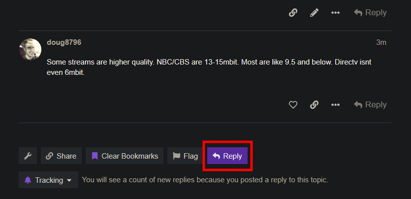

Some streams are higher quality. NBC/CBS are 13-15mbit. Most are like 9.5 and below. Directv isnt even 6mbit.
@doug8796 When you're posting a message on a thread that's not intended as a reply to the previous post, be sure to use the button highlighted in red. If you use the reply button in the previous message, that person gets a notification, which in the above message (and several others where I'm the previous poster) is not what you're intending:
Apologies - I was somewhat responding to you as the variables seem to have a lower bitrate than they could for NBC and other high quality sources. I wish it could just differ to the js file.
Alright I think we're in business! I did things exactly how you stated this time and now all seems good! I did multiple reboots of the server and everytime it came back up, the cc4c container loaded normally and weatherscan and my various live web cams all load in channels just fine! So I won't hold my breath...lol! but this time it seems the solution may have finally worked! Thank you for all your help and hard work!

I tried many things, but for my last attempt to ensure nothing hanging around:
  1. Dropped my container,
  2. Dropped both your and fancybit's images
  3. Ran the RUN command from your PR, to whit:
sudo docker run -d   --name cc4c   --shm-size=1g   -p 5589:5589   -p 5900:5900   -e HOST_VNC_PORT=5900   -e VIDEO_BITRATE=9500000   -e AUDIO_BITRATE=256000   -e FRAMERATE=30   -e CC4C_PORT=5589   -e VIDEO_WIDTH=1920   -e VIDEO_HEIGHT=1080   -e VIDEO_CODEC=h264_vaapi   -e AUDIO_CODEC=aac   -e TZ=US/Eastern   -v cookies:/home/chrome/chromedata/Default/Cookies   -v logins:/home/chrome/chromedata/Default/Login\ Data   -v localstorage:/home/chrome/chromedata/Default/Local\ Storage   -v prefs:/home/chrome/chromedata/Default/Preferences   -v secure:/home/chrome/chromedata/Default/Secure\ Preferences   --restart unless-stopped   bnhf/cc4c:latest
  1. Re-enabled the source and tried to view, didn't work, got the message above.
Could you post the whole log please from container start, to after one failed virtual tune?
