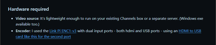

I added support for multiple encoders now. I tested it with the Link Pi ENC1-V3 on two concurrent streams and it works pretty well. Redirecting the browser sound to the proper encoder input was a bit challenging to deal with so I'm not sure if the method will work with all the streaming sites but I did test with Sling TV.
