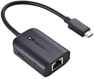

Anyway, I recently discovered one way to significantly improve performance - use a third-party Ethernet adapter. The Google Ethernet adapter is limited to 100MBps, and while that is usually fine for streaming, using rewind and fast forward on video recorded OTA without additional compression can benefit from more speed. I bought a Cable Matters USB-C Ethernet adapter designed for the Chromecast, and now rewind/fast-forward is less sluggish and my speed test shows 350MBps (you don’t get the full gigabit due to the limits of the USB port). Fast-forward and rewind still seem to work better on the Apple TV, but I think that’s a difference in UI rather than performance at this point,
One note - if you go this way, you want to make sure the Chromecast and DVR server are connected by Ethernet to the same router/hub, and make sure neither are connecting to Wi-FI. When I first tried I only got 80MBps, but discovered my Chromecast was connecting to the IP assigned to my DVR computer’s Wi-Fi interface. Also, if you get a more complex USB-C hub rather than just an Ethernet adapter with USB-C power passthrough, you may need another power adapter to supply enough power.

Would you mind providing a link to the exact one you purchased?
Reading the specs, there is no mention of USB-C Power Delivery (PD) support, only power pass through.
The Cable Matters model posted above yours is both less expensive and supports PD. Were I looking solely for an Ethernet adapter for the CCGTV, I know which I'd choose.
I’m not sure USB PD is really important unless you’re using a hub - I chose the Cable Matters one because it was known to support the standard Google power adapter (which is not USB-C PD) and work at speeds above 100MBps. It sounds like the Wasserstein one is the same, though the Cable Matters does cost less. I would have purchased a hub, but I don’t have a huge need for USB at the moment and all the hubs I saw seemed to either need a bigger power supply (an additional expense), have iffy reviews, and/or only do Ethernet at 100MBps.
