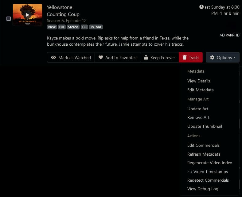

You can show us the closed captions in the recording.

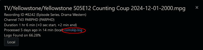

Do Edit Commercials on the recording and click the highlighted comskip.log
It will open the comskip log in your browser.
Search for Closed caption transcript and copy/paste these 13 lines into your post

Where do I find "Edit Commercials"?
:gear: Options dropdown on the recording
My (short 5 minute) test recording did not have any commercials, so this menu item did not appear. I'm making a longer recording and will try again.

Here is the start of what I got. What does it tell you?
0) S:     1 E:    45 L:   0
1) S:    46 E:    56 L:  18  Sadly enough, no.
2) S:   147 E:   178 L:  54  Okay, okay, just so you understand, this is my house,
3) S:   240 E:   265 L:  47  and you don't get to invite people to move in.
4) S:   300 E:   330 L:  57  Why do you keep harping on that? She is not living here.
5) S:   372 E:   407 L:  63  I'm just gonna throw in a load of laundry before I go to work.
6) S:   567 E:   580 L:  24  Sure looks like she is.
7) S:   663 E:   686 L:  38  I don't know what he's talking about.
8) S:   757 E:   780 L:  38    Men men men men manly men men men
9) S:   852 E:   877 L:  43    Men men men men  Oo-o-oh oo-o-oh ooh ooh
10) S:   924 E:   936 L:  20    Manly men men men
11) S:   967 E:   983 L:  28    Men men men men manly men
12) S:  1053 E:  1070 L:  30    Ooh hoo-hoo hoo-hoo hoo ooh
13) S:  1099 E:  1122 L:  38    Men men men men manly men men men
14) S:  1203 E:  1208 L:   6    Ooh
15) S:  1223 E:  1246 L:  38    Men men men men manly men men men
16) S:  1295 E:  1310 L:  23    Ha ah ha-a-ah  Men
17) S:  1564 E:  1579 L:  29  Hey, listen, I was thinking.
18) S:  1595 E:  1624 L:  55  Why don't we bring my bed over from my mother's house?
19) S:  1729 E:  1745 L:  28  We-we've already got a bed.
20) S:  1776 E:  1800 L:  40  This isn't a bed. It's a foldout couch.
21) S:  1820 E:  1850 L:  54  And you're the one who's always complaining about it.
22) S:  1881 E:  1906 L:  44  Oh, pfft, I complain about a lot of things.
23) S:  1957 E:  1978 L:  40  Like, uh, like automatic-flush toilets.
24) S:  1998 E:  2033 L:  65  I mean, everything's gone before you get a chance to turn around
25) S:  2091 E:  2105 L:  27  and check out how you did.
26) S:  2154 E:  2177 L:  40  What the dickens are you talking about?
27) S:  2207 E:  2233 L:  46  Let's just leave the furniture the way it is.
That the recording has closed captions beyond a shadow of a doubt and that comskip was able to read them, so the Channels clients should display them. Can you select them using the Channels client on your FireStick or Android?
On the FireStick, ONN, and my Android phone, while the show is playing, it offers me the option to turn on closed captions. If I select the option, it shows a check mark indicating that they are there and turned on, but no captions show. Under Windows, the captions work fine.
I have an old iPad that has not been used in years. If I can get it to power up, I'll see what happens there.
Ken
I finally got my old iPad running. The captions work fine on the iPad. So it looks like only Android based clients fail.
