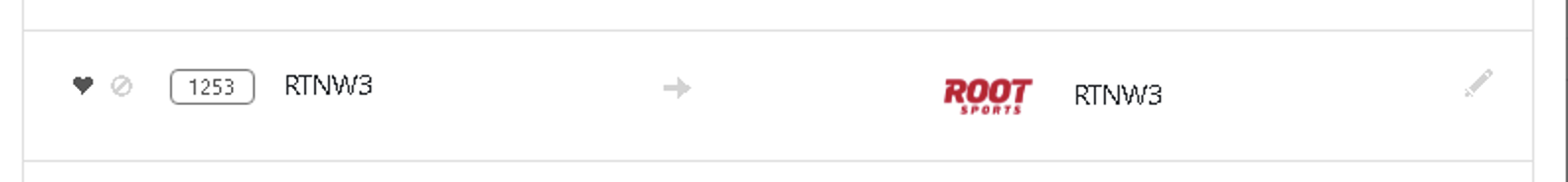

Recently in our area they added an extra channel with Comcast for Root Sports. This is channel 1253. I have deleted provider and added it back in. Also tried to redownload guide. The guide for this channel still shows as blank.
I know there must be a guide somewhere as recently on Fubo TV the guide does work for this channel.
Anyone have ideas? All other channels, mappings, and guides work great.

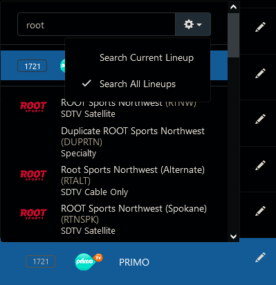

Click the pencil icon, then the dropdown to select Search All Lineups
Lots of choices there.
Screenshot 2022-01-20 at 15-32-27 Channels Settings
If it shows correctly in the HDHR app you can sync that to Channels DVR.
Does it show in your lineup at zap2it.com ?
