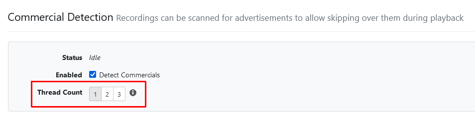

What did you set comskip thread count to?

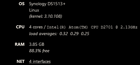

Can you view the CPU load averages and RAM usage when the issue occurs?
cpu load averages
1 cpu, usually when the issue starts I get frozen out of all interfaces
The few times I got the page to load I had at least 70% ram free and loads were about 2
