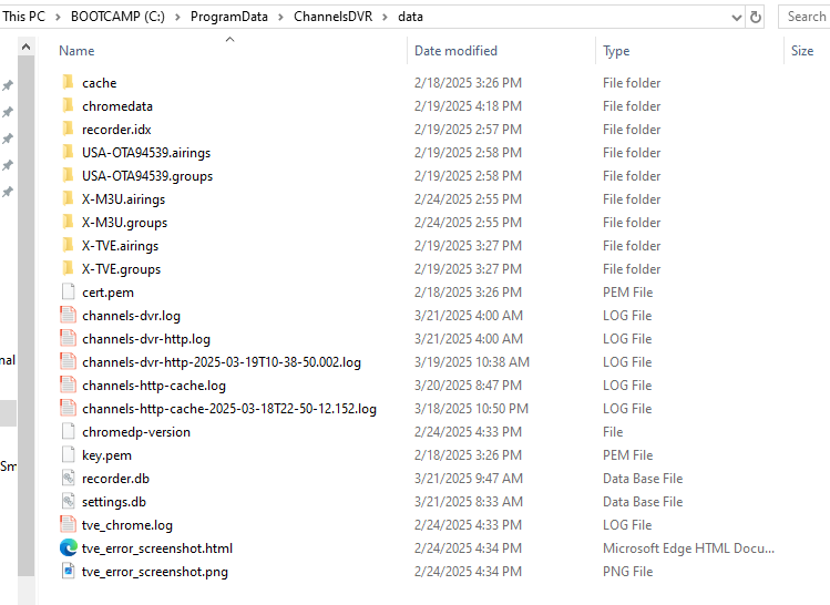

The path you provided seems to be a MacOS/Unix type path. On windows I don't see any "logs" directory at all. The logs that I find are in the ChannelsDVR\data folder, which looks like the screengrab below (and has a bunch of log files). Is there a different "logs" folder somewhere else in Windows? I tried searching for it, but can't seem to find anything. Thoughts?
Yes there's one next to your recordings
