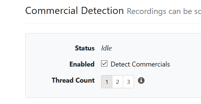

Thanks @TV_Ken my settings only has a checkbox for the commercial detection, where do I define auto or manual? Also, where did you up the threads to 2?

To set the commercial detection threads, go to the web page on the server and check the box for Commercial Detection, then if you have a recent copy of the server software you will then get an option to choose the number of threads. My server DVR is on Windows 10 - not sure this has yet been implemented on all versions of the DVR software so it may or may not be available on all NAS.
The DVR server is the same across all platforms. However, the option in the web UI to adjust the number of threads for commercial detection is only available on a prerelease version.
