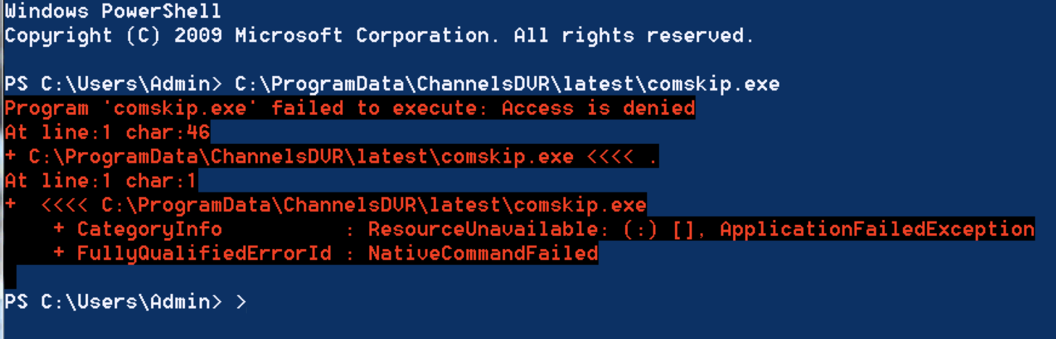

Strange. What happens if you open PowerShell and run:
C:\ProgramData\ChannelsDVR\latest\comskip.exe

What does it say in the shell when you run that command?
Okay that means the Access Denied error is still happening, even when you run it yourself.
I don’t know enough about windows to know why this would be happening…
Do you have the DVR installed in the system tray, or as a windows background service?
I get access denied when trying to run it myself, even as a administrator

Yea super weird. I’d say maybe try reinstalling the software. Run our installer utility and select uninstall, then install again.
After installing you’ll want to open http://127.0.0.1:8089/restore to find the most recent backup to restore all your existing passes and recordings.
