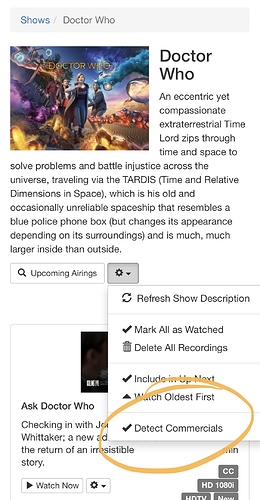

You can edit a recorded show on the web UI to disable commercial detection

That works if the show is already recorded then I can select that for future recording but that does me no good if the show hasn't been recorded yet and I don't have any previous recorded shows to access that setting. Why can't that setting me added when setting up a season pass?
You can go the opposite route:
Uncheck the "Detect Commercials" option under the "Basic Setup" section, and then selectively enable commercial detection for series after the fact.
The problem is that the web UI is limited, and as I understand it was not really intended to be a primary interface. To this end, the option for enabling/disabling commercial detection is only visible from the Recordings view of program, and the options drop-down is only present if there is at least one recording of that program. Otherwise, you get a blank screen with the text: "No recordings found for show."
