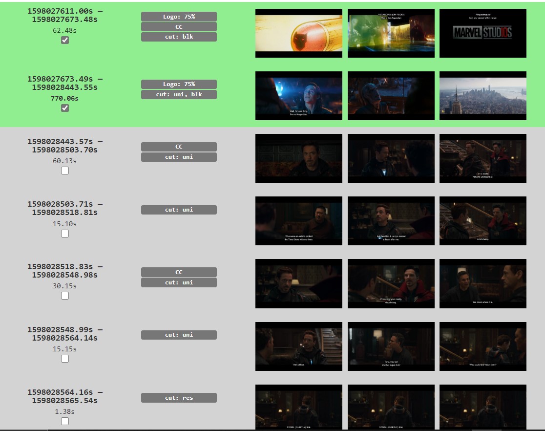

This is a snapshot of INFINITY Wars and darks scenes were marked as commercials.

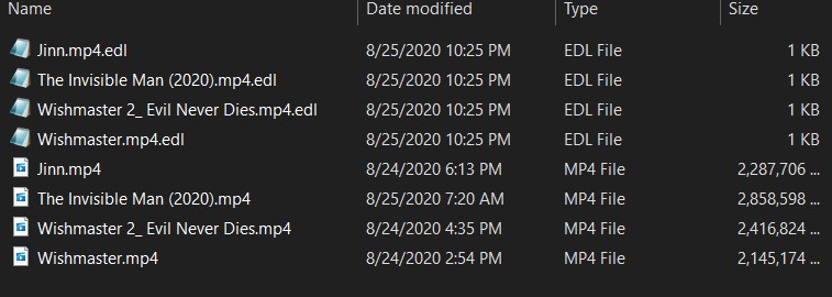

Does the DVR log show comskip running?
I see you're pointing out .EDL files with a current date, but comskip takes awhile to run.
So it doesn't seem like comskip is actually running on the imported movies.
Just something wierd with the .EDL files modified date.

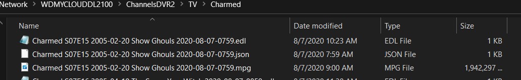

Something Weird is happening I think you game me an idea ... Thanks chDVRuser for suggesting something weird is happening... That Episode of charmed I moved to my secondary folder but it does not show up in Channels DVR ... IT appears that Imported file took the Charmed ID for some reason.

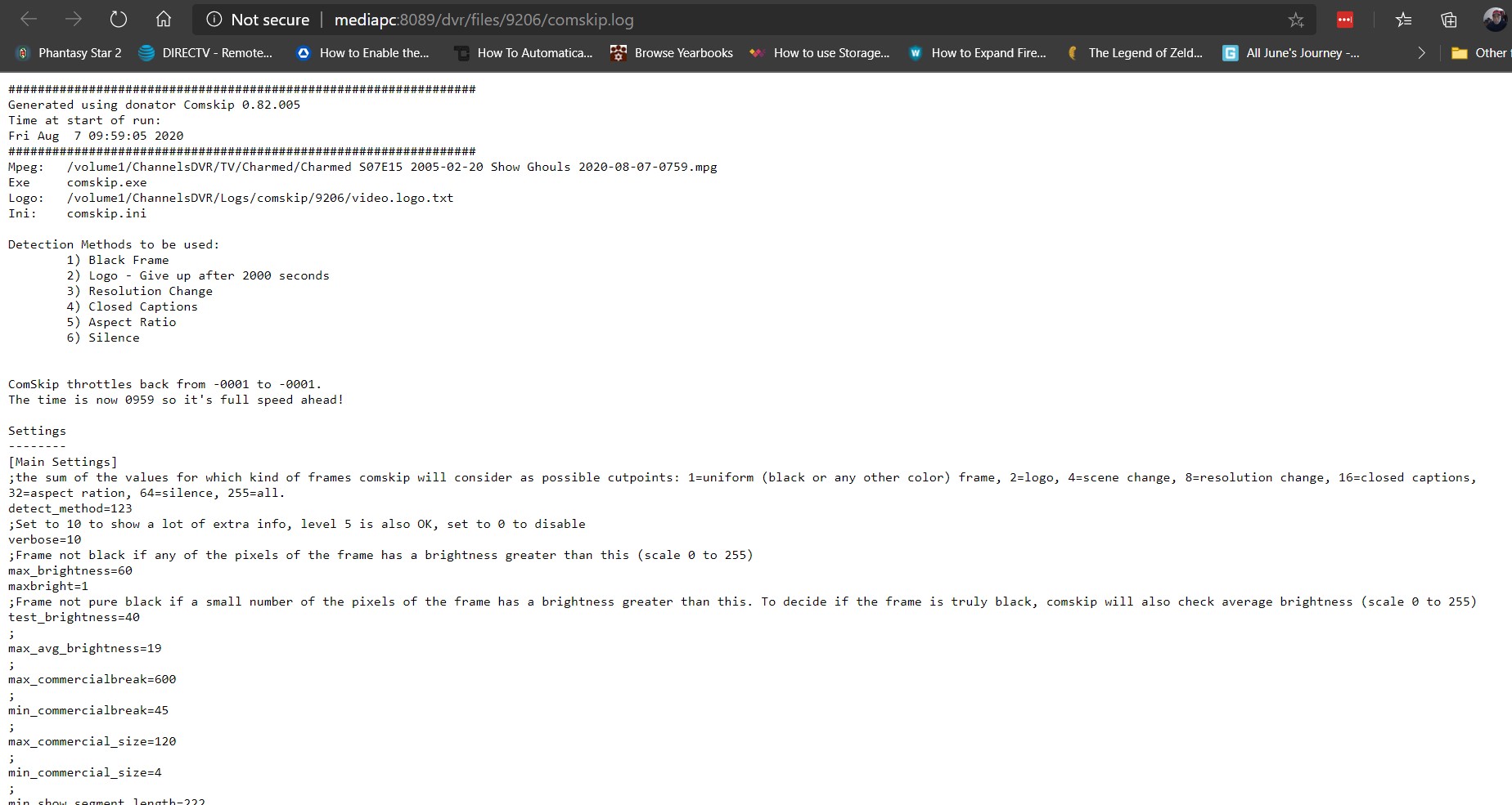

Here is the header of my Imported Movie ....
The Invisible Man (2020).mp4
Recording ID #9206 (Movie Feature Film, Horror Thriller)
Channel
Duration 0 sec (+-1598369034 sec start, +443993 hrs 29 min end)
Processed 20 days ago in 25 min (local) comskip.log
Logo Found on 58.72%
Here is part of the log with the same ID ....

Generated using donator Comskip 0.82.005
Time at start of run:
Thu Aug 6 22:06:37 2020
Mpeg: /volume1/ChannelsDVR/Movies/He's Out to Get You (2019) 2020-08-06-1959.mpg
Exe comskip.exe
Logo: /volume1/ChannelsDVR/Logs/comskip/9192/video.logo.txt
Ini: comskip.ini
Detection Methods to be used:
1) Black Frame
2) Logo - Give up after 2000 seconds
3) Resolution Change
4) Closed Captions
5) Aspect Ratio
6) Silence
