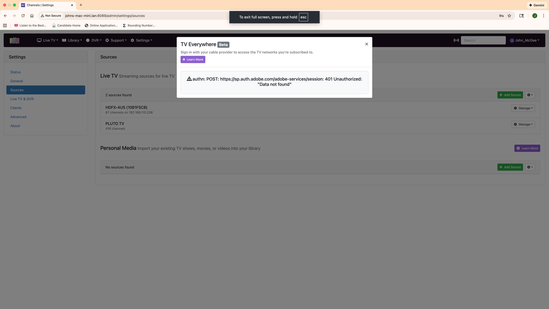

Just confirming that the newer DirecTV Entertainment Pkg, about $35, in not compatible with TVE. I noticed an error when trying to add to channels as a source. At first, I thought it was an authentication issue, but then I dug and determined it's just not offered in that pkg. Just confirming with anyone that may have a different experience.

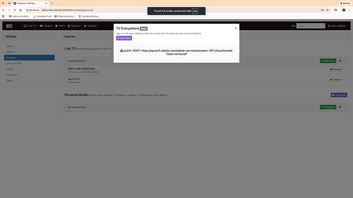

BTW, I'm running 4/1/25 pre-release. Here is the error I get when trying to add: authn: POST: https://sp.auth.adobe.com/adobe-services/session: 401: "Data not found".
Tried on Edge and Chrome.

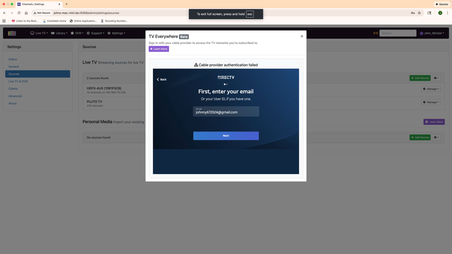

I found that in order to get the Genre package to authenticate I had to choose to use DirecTv vs DirecTv Stream.
I just stumbled on that solution seconds ago. Thank you very much for the reply. That DirecTV was staring at me for days. I was sure I needed to choose Stream!
Thanks again,
Mark
Apparently, I did choose Directv without the Stream by sheer luck. Not sure that the Stream entry was even available when I added my TVE connection. At any rate maybe that clears up why some are having problems.
