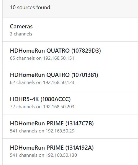

@Edwin_Perez please show a screenshot of your sources, if you don't mind.
I'm not sure exactly how HDHR works with Channels.
With the Quatro device, shouldn't there be 4 sources created by Channels since it has 4 tuners? It looks like there are only 2 sources for it.

Thank you for the logs. I can clearly see that my script combined the two Quatro sources into one, as you mentioned previously. At first, I was not sure what you meant but now that's clear.
I confirm that this is a bug that I need to fix. Sorry for the inconvenience.

Deleted source: "HDHomeRun PRIME"
Deleted source: "HDHomeRun QUATRO"
Deleted source: "HDHR5-4K"
New source with 65 channels: "HDHomeRun QUATRO 107829D3"
See file /config/192.168.50.215-8089_data/HDHomeRun_QUATRO_107829D3.log for the full lineup.
New source with 62 channels: "HDHomeRun QUATRO 10701381"
See file /config/192.168.50.215-8089_data/HDHomeRun_QUATRO_10701381.log for the full lineup.
New source with 72 channels: "HDHR5-4K 1080ACCC"
See file /config/192.168.50.215-8089_data/HDHR5-4K_1080ACCC.log for the full lineup.
New source with 541 channels: "HDHomeRun PRIME 13147C7B"
See file /config/192.168.50.215-8089_data/HDHomeRun_PRIME_13147C7B.log for the full lineup.
New source with 541 channels: "HDHomeRun PRIME 131A192A"
See file /config/192.168.50.215-8089_data/HDHomeRun_PRIME_131A192A.log for the full lineup.
