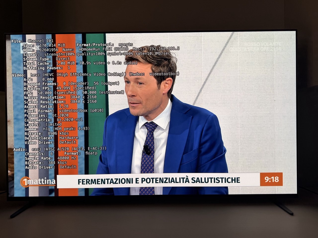

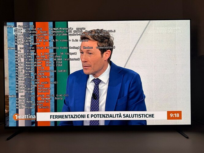

A new 4K HDR HLG live channel has been added in italy DTT channels, match content is on and i noticed that my sony tv switches in dolby vision mode instead of standard HDR HLG mode.
This causes random image flashing and brightness changes maybe because it's not using the right color space and it's not using the right HDR mode.

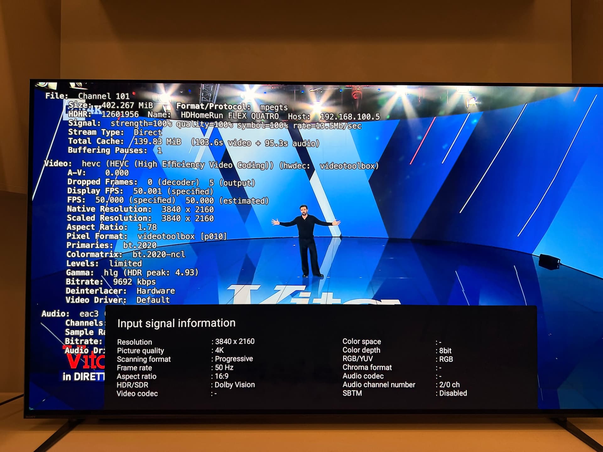

I tried to lock the tv on the standard HDR mode and the flashing does not happen, but under standard settings it switches to Dolby vision mode
Here are the full stats of the glitching channel, it's a dvbt2 hevc channel running on 4k hlg hdr making the tv switch in dolby vision mode instead of standard hdr.

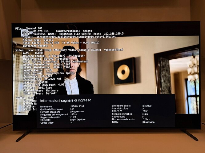

If you need something else to figure out the issue, i can send some screens about the apple tv or the tv video settings :wink:
With the latest beta release the switching works in the right way as the tv goes into HDR10 mode
