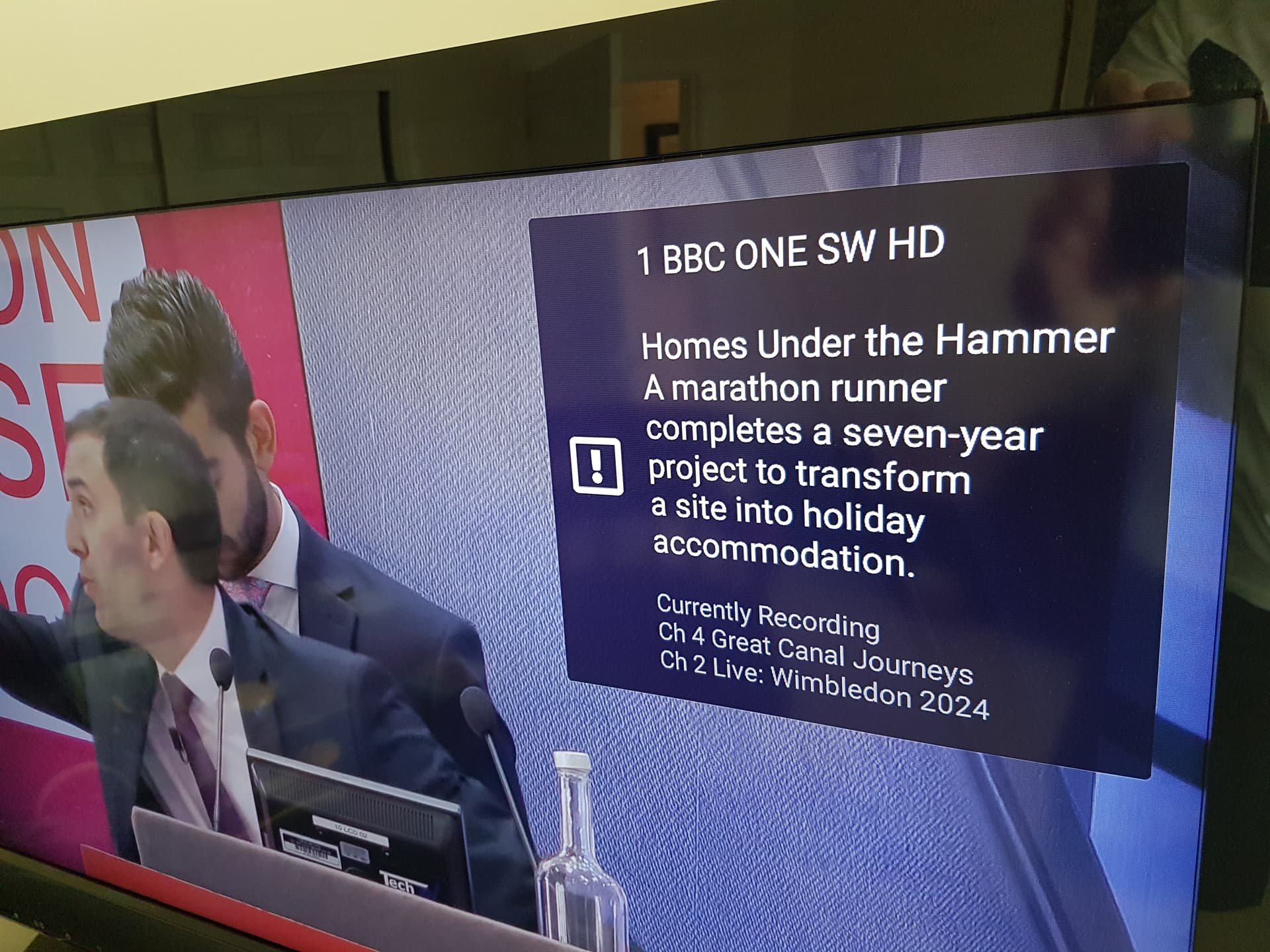

In case anyone is interested as to why I want this info, I have my own custom "Info" button pop up that I create in my Node Red using the API notify feature. It gives current program details for that client and a list of any currently recording programs from the server.
It take up less space on the screen than using the pulldown for full program info and is also a quick to check for what is currently recording.
If only I could get rid of, or change, the "!" as the icon on Android.........
