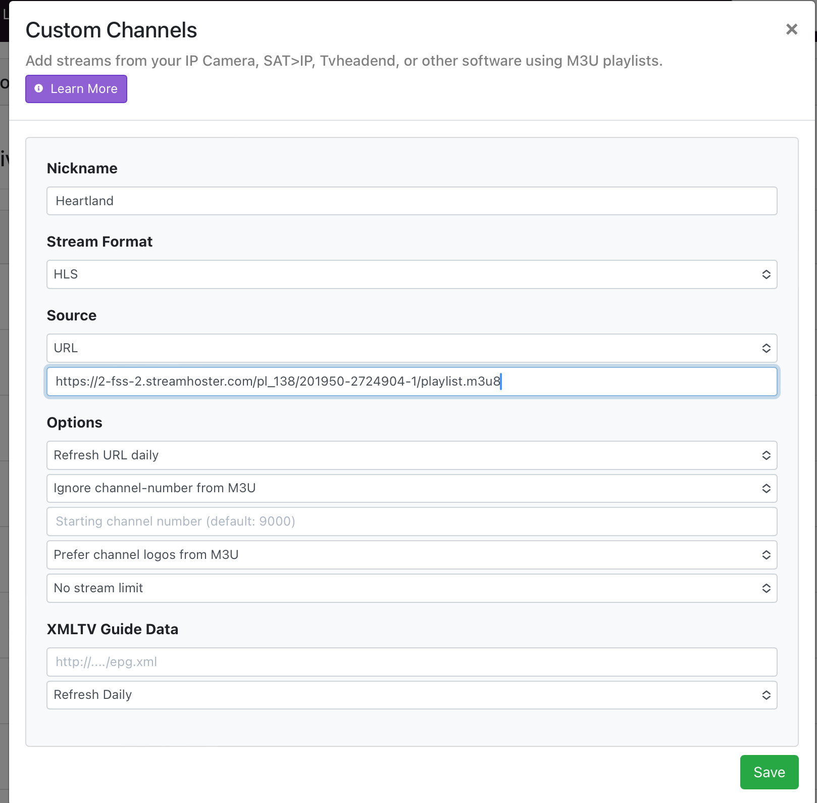

I have tried creating a custom channel using HLS, Mteg and streamlink and all those times it says the m3u link is bad. :frowning:

I am a bit confused and I apologize. When I click on the above links, it takes me directly to the stream and I can watch that channel. Usually I just have to copy that type of link and past it into the URL field when creating a custom field, but that isn’t working for some reason.
I understand you're confused, and that what you are doing isn't working. This is the reason why I asked for you to post the actual text you are using for your M3U playlist.

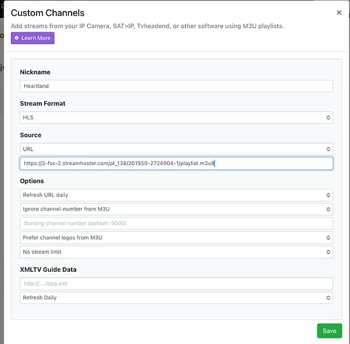

Okay. I am sorry. I just tried it again and snapped a picture. See attached. I really appreciate the help.
As I stated earlier, the URLs are not M3U playlists. You have to create one listing those. You need to change the Source to Text, and enter something like:

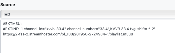

Thank you. I was tinkering with this all night long last night and I don't think I ever got it to work. Is this how it should look in the text?
Screenshot 2025-06-23 at 1.27.57 PM
No. All the tags need to come before the name. The format is:
#EXTINF:duration tag1="value1" tag2="value2" […],title
item
For live streams, the duration is always -1. Everything after the comma is considered that entry's title/name. The following line describes where to find the media described above.
I have never had a colon : behind
#EXTM3U
Not sure if that's a problem or not
You're right, that's a typo on my part. Thank you.
I see you meant for the OP, not me. Correct, there is no : in the initial line of text.
