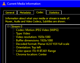

It's an MJPG video with no audio.
Copy the url and paste it into VLC player as a network stream.

Actually it does have audio, just no volume to it.
Here's what my video editor says about the stream after downloading it to a file.

No audio in it.
My video editor muxes in silent audio to maintain sync if the source has no audio stream.
The screenshot from VLC above is correct, video stream but no audio stream.

…”The JPG designator you stumbled upon is actually MJPEG.
Our cameras can offer H.264 or H.265 as well.
Tried it as a custom channel MPEG-TS and appears Channels DVR doesn't like something.
Not sure if it's the lack of an audio stream, or being MJPEG video or what.
ffprobe does show the single MJPEG video stream but no duration or bitrate
Input #0, mpjpeg, from 'tortola.jpg':
Duration: N/A, bitrate: N/A
Stream #0:0: Video: mjpeg (Baseline), yuvj420p(pc, bt470bg/unknown/unknown), 1920x1080 [SAR 1:1 DAR 16:9], 25 tbr, 25 tbn, 25 tbc
