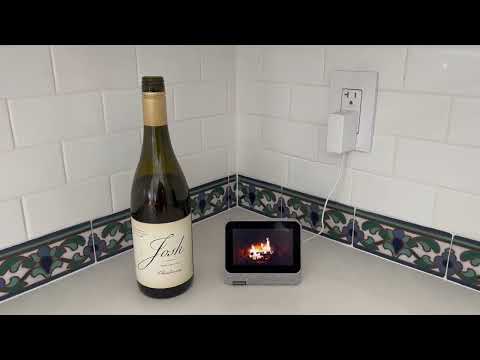

It's chilly out today. Perfect timing to warm things up and get a little fire going.
