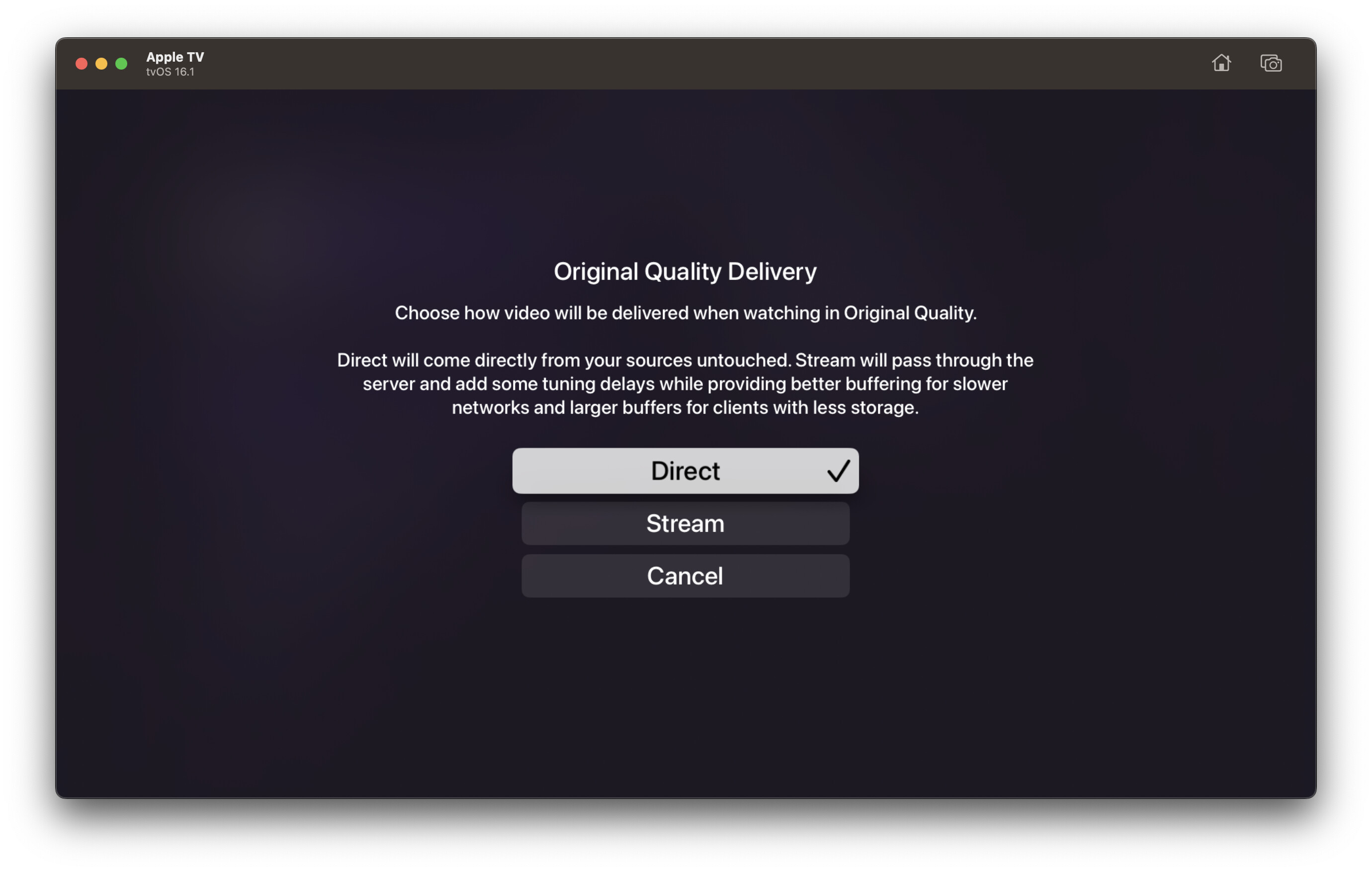

I just seen this added as a Server Side option in the latest beta, thanks guys. Can you please explain the difference specifically between them? I only use "Original Quality".
TIA
Direct is what it normally does. Stream always uses HLS, which is what is always used when away from home or transcoding. Check it out in the app as it explains it there.
Stream ... HLS will use the Server for LIVETV buffer I believe.
Does this effect all devices or just Apple devices? By reading the screenshot above it sounds like "Stream" is a no-brainer? What would be some advantages of choosing "Direct"?

The no brainer choice when using an atv or any device that has plenty of storage for pause buffer would be “Direct”. Using stream would cause unnecessary tuning delays for no real gain.

Direct
Direct uses MPEG-TS over a single TCP connection. This has the benefit of having the lowest latency for tuning and lowest overhead for your DVR and network. The downside is that it is susceptible to experiencing issues if there is high latency (which is why we do not use this for Away From Home streaming). When watching live from a HDHomeRun, a connection is made directly from the app to the HDHomeRun, bypassing the DVR entirely. If two apps are watching the same channel at the same time, it will use two tuner slots on the HDHomeRun. When watching live from TVE, a connection is made to the DVR because all TVE streams are served by the DVR. The client stores the entire Live TV buffer locally.
Tuner Sharing
Tuner Sharing is a feature that modifies the behavior of Direct to cause live TV streams going to the HDHomeRun to go through the DVR, allowing for multiple apps watching the same channel to only use a single tuner on the HDHomeRun. This setting does not change the behavior of watching TVE streams. The DVR buffer holds a small number of seconds of data so it is still the responsibility of the client to store the entire Live TV buffer locally. This doubles the amount of network traffic and can lead to flaky problems if the DVR is overloaded or the network is at its limit (from being over WiFi or other such issues).
Stream
Stream uses HLS which uses many HTTP requests. This has the benefit of being able to handle high latency and variable network conditions much better than a single TCP connection and can recover from intermittent network issues. When watching Live TV from any source, it will be processed and served from the DVR (but it will not be transcoded). Because each HLS segment is 1 second and the additional processing that must happen, tuning into Live TV can take 1-3 seconds to load (which is generally higher and less consistent than Direct). This is also putting small additional CPU and disk IO load on the DVR, which generally is not a problem, but can cause issues if the DVR or disk is overloaded. The server stores the entire Live TV buffer and the client will store as much of it as it can handle with the available disk space.
What should you do?
If you're not having any problems, don't change settings. Direct streaming without Tuner Sharing will give you the most reliable experience in the most situations.
If you have particular reasons to change the settings, please use these settings to make your experience better.
Us developers of the product use Direct and have Tuner Sharing enabled because we have a reliable network and reliable DVR with lots of resources, but it all depends on your specific situation what makes the most sense for you.

I am leaning towards forcing everything to Stream. I assume this will only effect LAN devices compared to how it is handled now without making any changes?
Currently I have Tuner Sharing enabled.
Question: Without making any changes, if a LAN device is watching ch3 from the HDHR and a remote device requests ch3, will it use up 2 tuner slots since the LAN is using Direct and the remote device is HLS/Stream?
If I force all devices to Stream would the 2 devices only use 1 tuner slot instead?

Yes, it only impacts LAN devices.
This is what Tuner Sharing controls. If you enable Tuner Sharing, all of the local clients will share a single tuner with the remote devices.
This is not necessary if you enable Tuner Sharing.
