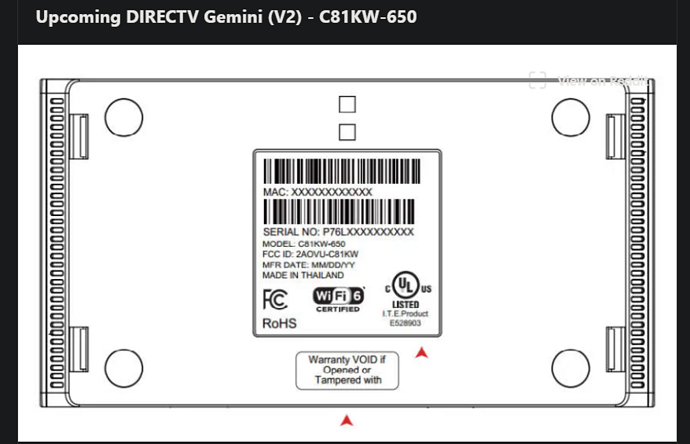

Good news, everyone!
Upcoming DIRECTV Gemini (V2) - C81KW-650
by u/513 in DirectvStream
I saw that.

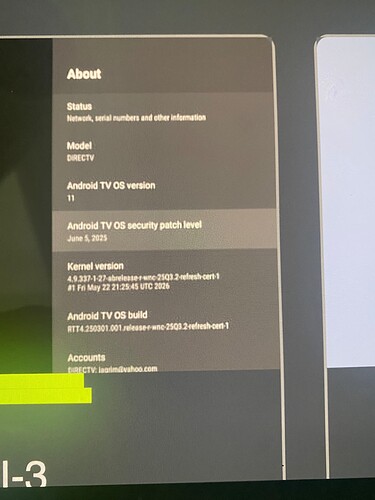

Where do you look for when an Osprey receives an update? Maybe I didn’t get that update.
Seems like this is rolling out to people. I just happened to notice yesterday I couldn't tune. The rollout is server side so it may be staggered.
Looks like I got that on 5/22.
Thanks for the pointer on where to find it. I only checked 1 Osprey.

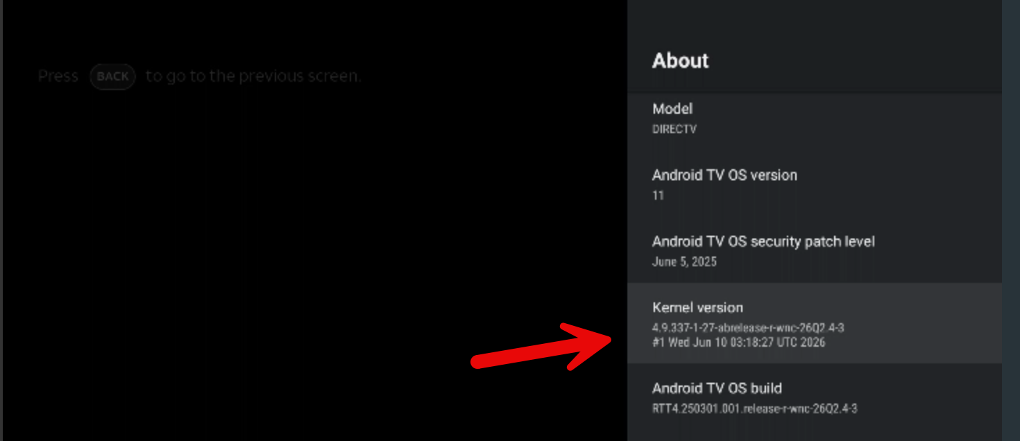

Look at your kernel version. Mine is Jun 10th yours is May 22nd. So I figured this out with Claude and tons of debugging.
