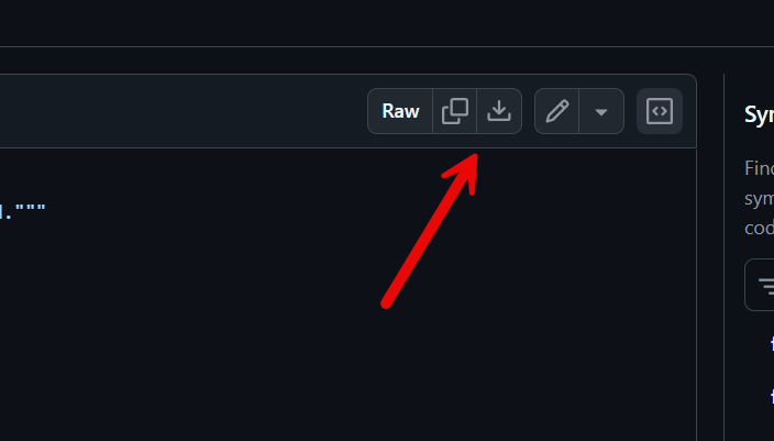

just installed python on win11, getting this.
PS C:\> python3 generate_directv_m3u.py
  File "C:\generate_directv_m3u.py", line 159
    <title>directv-AH4C-m3u/generate_directv_m3u.py at main · mackid1993/directv-AH4C-m3u · GitHub</title>
SyntaxError: invalid character '·' (U+00B7)
It seems to work on Windows, just make sure you do copy as cURL bash. Also looks like you downloaded a webpage. Click this.
these 2 things. I always end up doing the cURL cmd.. :face_with_monocle:
worked, thanks! much cleaner than manual adbtuner conversion I did. :wink:
Try curl bash. That is what worked for me on Windows and what the script expects.
Also, it just reads it off the clipboard. So you want it on your clipboard, and then you just hit enter. You just copy it to the clipboard. You don't have to paste it into the terminal window. That might be where it's going wrong.
