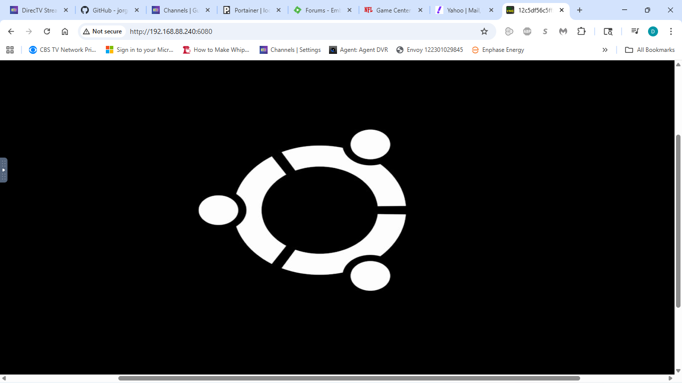

This is what I get on the admin screen now.

I don't seem to be able to access the gui. I'd like to figure out if I have this container set up correctly before I get too far into testing. It's getting late and I'll have to pick this up again some time tomorrow.
