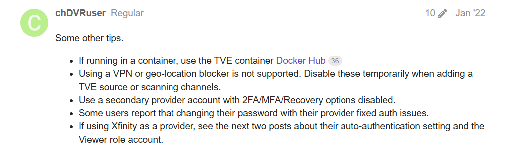

I was having the same problem. However, I went through the TVE Troubleshooting Tips and was able to get mine up and running again.
It's worth noting that I've used those troubleshooting tips before for the same problem, and each time I use them, it seems to be a different tip that ultimately solves my problem.
You should bookmark that page; it's a life saver!
I verified all of those tips were done, and I still couldn't authenticate. However, I scrolled down in the conversation and found additional tips which did resolve it!
One tip said VPN is not supported, so I disabled my VPN. Everything authenticated successfully, and all my channels are available again!
Thanks for leading me to the answer!
