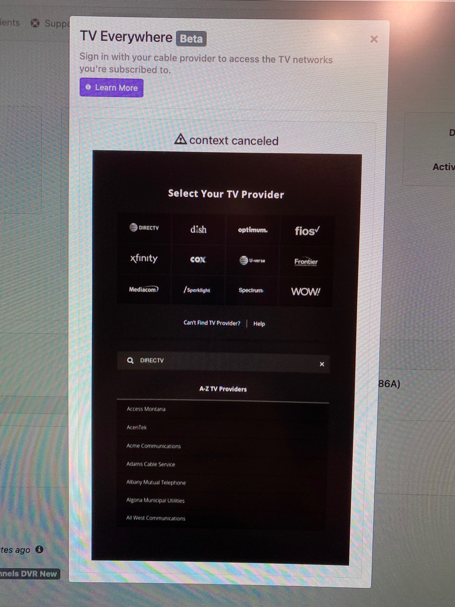

This is what happened when I deleted and tried to re-add the DirecTV source - context cancelled error and a mini web screen image....??

Still get the context cancelled image shown above if I try to add the source back now that I have deleted it

It types DIRECTV but the list below is not filtered. Could be due to old chrome. Did you check the chrome version? It should be listed in the logs.

Thanks for getting back to me - here is what the log looks like (I XXed out the email stuff). I am using Safari.

Too old and causing the issue.

That's quite old ... what OS is your server running on? Have you tried updating your Chrome/Chromium?
I am running the server from my Nvidia shield - so this isn't the computer browser (which is Mac/safari) that I am navigating the menus from?
