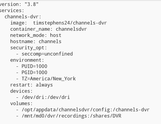

Can you show me how you’re running the container?
Maybe the security option is causing the issue with the changes you made?

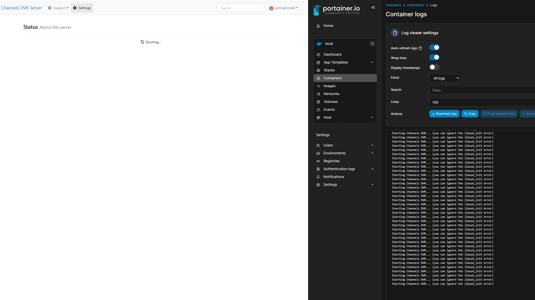

Pulling the image same issue.
After chown, boots up and spam logging stops

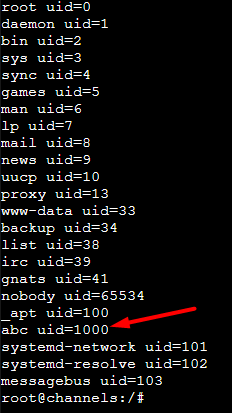

Who was the owner originally? UID 1000 user or someone else?
1000

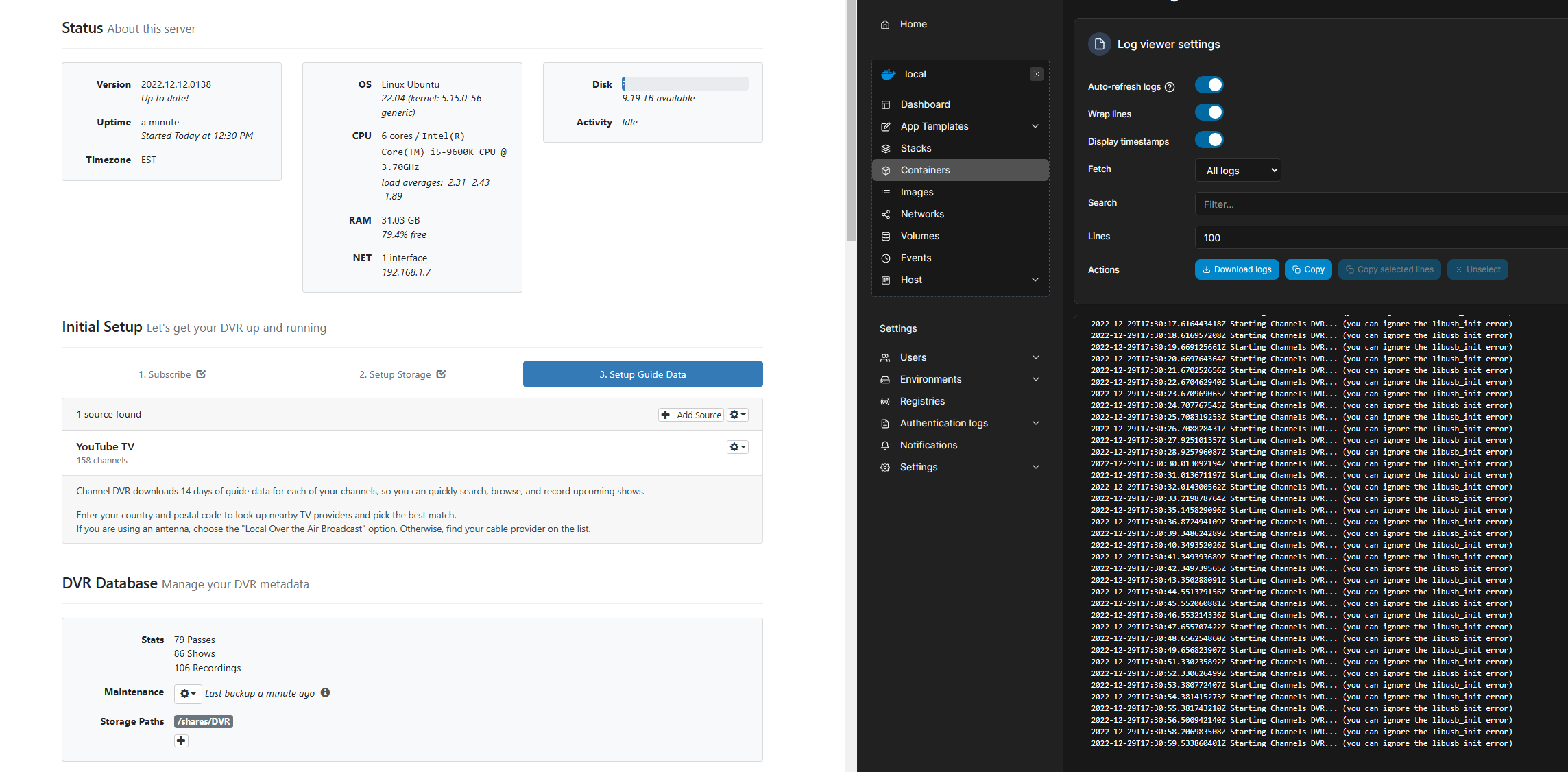

Seems like it only affected it after that very first run. I even remove the image and went back to fancy bit and came back again and it was still fine.
So I can leave it running and for a few days and see if anything changes

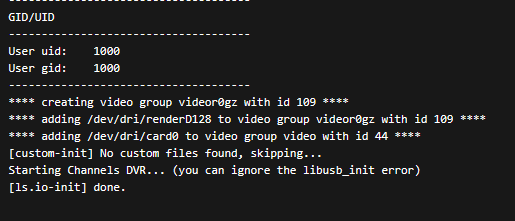

This is what the log shows when it boots correctly
And 1000 is showing in the user list so not sure
