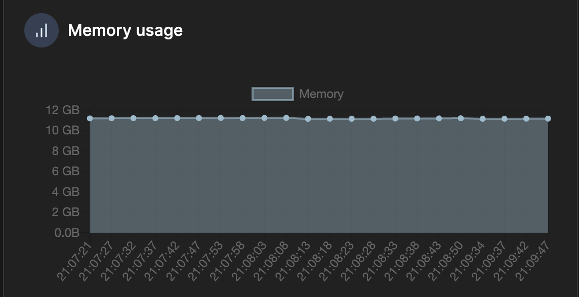

Docker container almost at 12GB Ram
I am in the process of migrating from QNAP to a docker container, and I peeked in on my VM's memory .. and YIKES.
Took a look at the docker containers I had running and Channels had gone wild!
Any thoughts?

One note... I think it's the docker container grabbing all that RAM
This is what Channels says rn

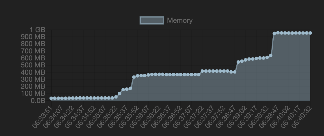

Quick update, this AM I tried to do a bit of debugging to see what might be causing the issues
I restarted the container, and the memory footprint seemed normal. Then I watched a show, and it shot up to 350MB. Stopped, and started another show, and it went to 600. I skipped ahead in the second show and it jumped to 1GB.
After closing channels the memory is never reclaimed.

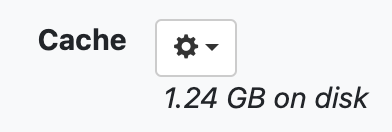

UPDATE: A bit more info.
The streaming 'cache' is balooning. I wonder where the cache is being held, and if it should clear out more frequently?
UPDATE 2: Cleared the cache but the container memory usage did NOT go down

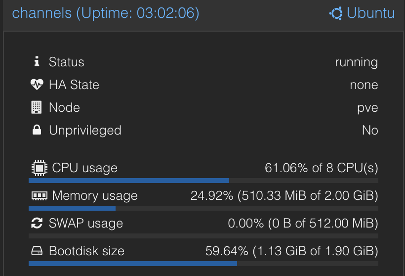

Circling back after doing some investigating. It seems that ffmpeg in docker has some strange memory behavior where it claims and does not release the memory.
I might switch to an Ubuntu LXC and install Channels in that to see if the problem goes away.

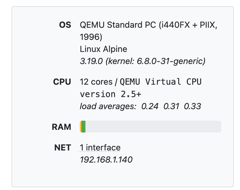

Welp, Channels running in an Ubuntu LXC on Proxmox gives me very stable / consistent:

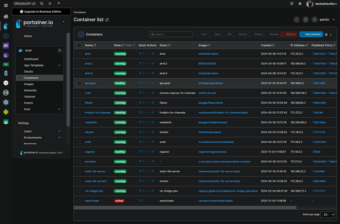

Here's an example of one LXC I run that has all of my Channels related stuff in it. You can create an LXC, add things like Docker, Portainer, Cockpit (with Navigator), and Organizr to it, and then make that into a template for future LXCs with Docker:
Which LXC template are you using? And allocations? Do you run the container priv'd and do you pass through any hardware from the host to the container?
