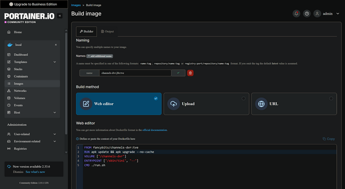

I did a quick little image update Dockerfile for you, that you can use in Portainer to create an updated image. This particular example takes the current channels-dvr:tve image and updates the base OS packages. This should work on whatever CDVR image you need.
This is a fast and easy process, and unlike the CDVR developers that have to consider ramifications for a much wider audience, this image has an audience of one -- you. :slight_smile:
Dockerfile:
FROM fancybits/channels-dvr:tve
RUN apk update && apk upgrade --no-cache
VOLUME ["/channels-dvr"]
ENTRYPOINT ["/sbin/tini", "--"]
CMD ./run.sh

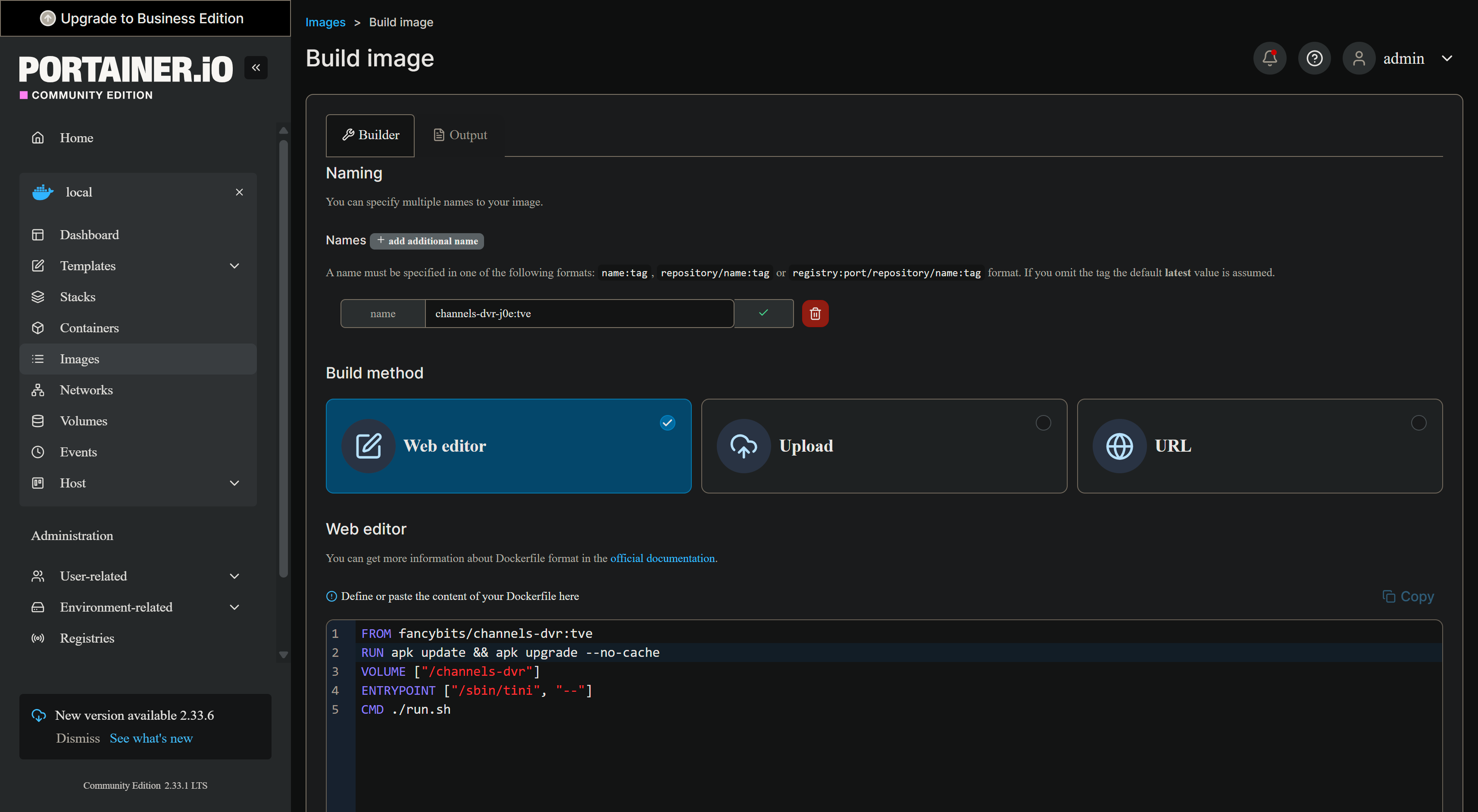

It'll look like this in Portainer-Images:
The output from the build (which is very fast), will look like this:

Then when deploying the image in Portainer-Stacks, you'd use this new local image like so:

Thanks for the detailed instructions and the screenshot! I was able to get it to work, had fun learning how to do it, and went ahead and purchased a yearly subscription as well.
