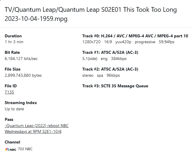

Does the DVR rewrite timestamps on an HDHR recording?
Have a recording that appears normal in the DVR UI, no interruption, yet the timestamps are messed up. Easy to see by looking at the comskip log. Note the lines beginning with jump and strange that shows the pts jumping all over the place.

Displays as full duration in Channels DVR and in my video editor
Capture
I semi rescued it by remuxing it with ffmpeg.
That dropped 15,048 frames or 4 minutes, 11 seconds from the recording, but it's now playable.
