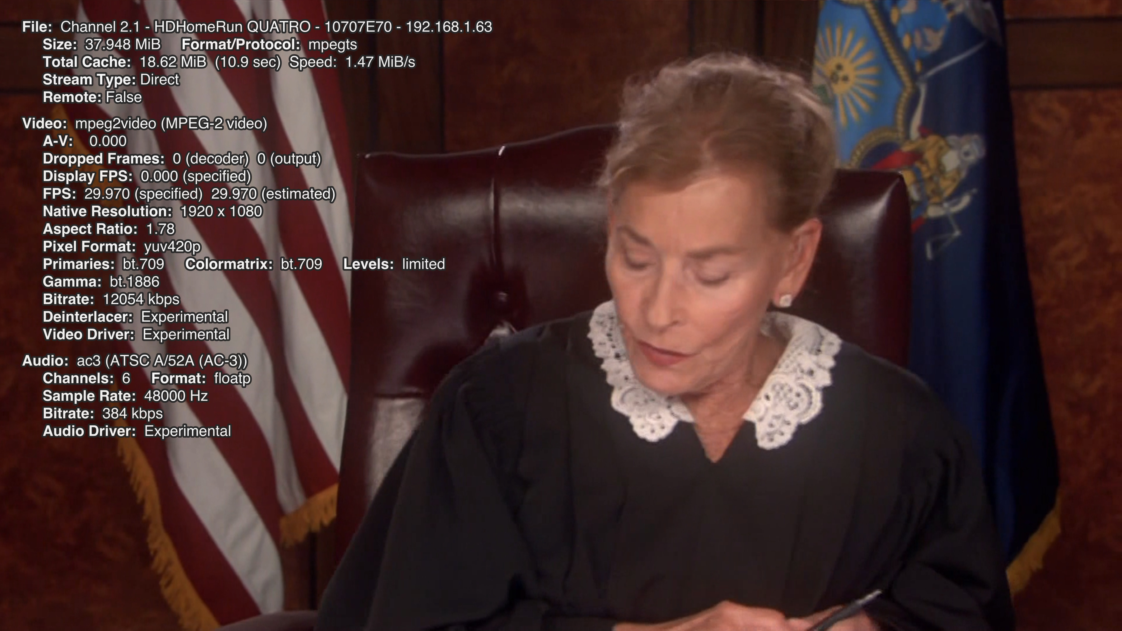

I have a Sonos ARC and I get 5.1 surround sound with my HDHomeRun and Apple TV 4K.
I even posted a photo of it earlier showing that I'm getting 5.1 in the Sonos app.
Your understanding and assertion that the HDHomeRun cannot supply 5.1 audio is incorrect.
