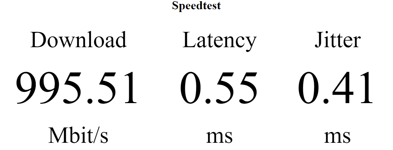

Have you tried a speedtest from another device ... PC ?
http://yourip:8089/speedtest
Using a PC on ethernet

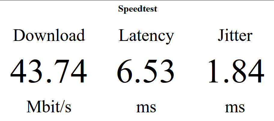

Using the same PC on WIFI

Both Firesticks are connected on 5G. Both have the same speedtest of ~60 Mbit/s.
The PC WIFI test above with 43.74 Mbit/s is also on 5g.
5GHz frequencies give faster speeds, but only when the devices are near and have clear line-of-sight. Increase the distance, or put walls in the way, and the speed quickly drops. Higher frequencies are also subject to more interference.
2.4GHz frequencies are much more resilient, and can handle distances much better than 5GHz can.

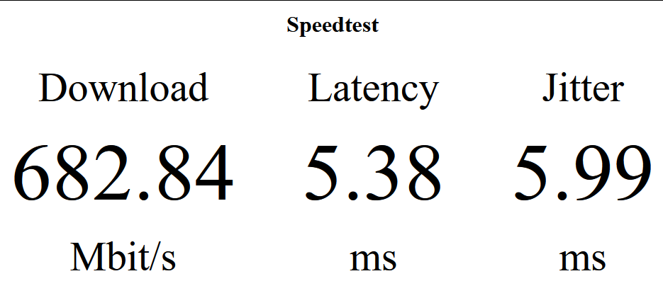

You definitely have some issues... That latency is terrible for wired on the same subnet. If things were fine with channels on the PC and are not now with it on the NAS, you should zero in there. Not sure what the problem is but you should be 1ms with no jitter on a wired network.
