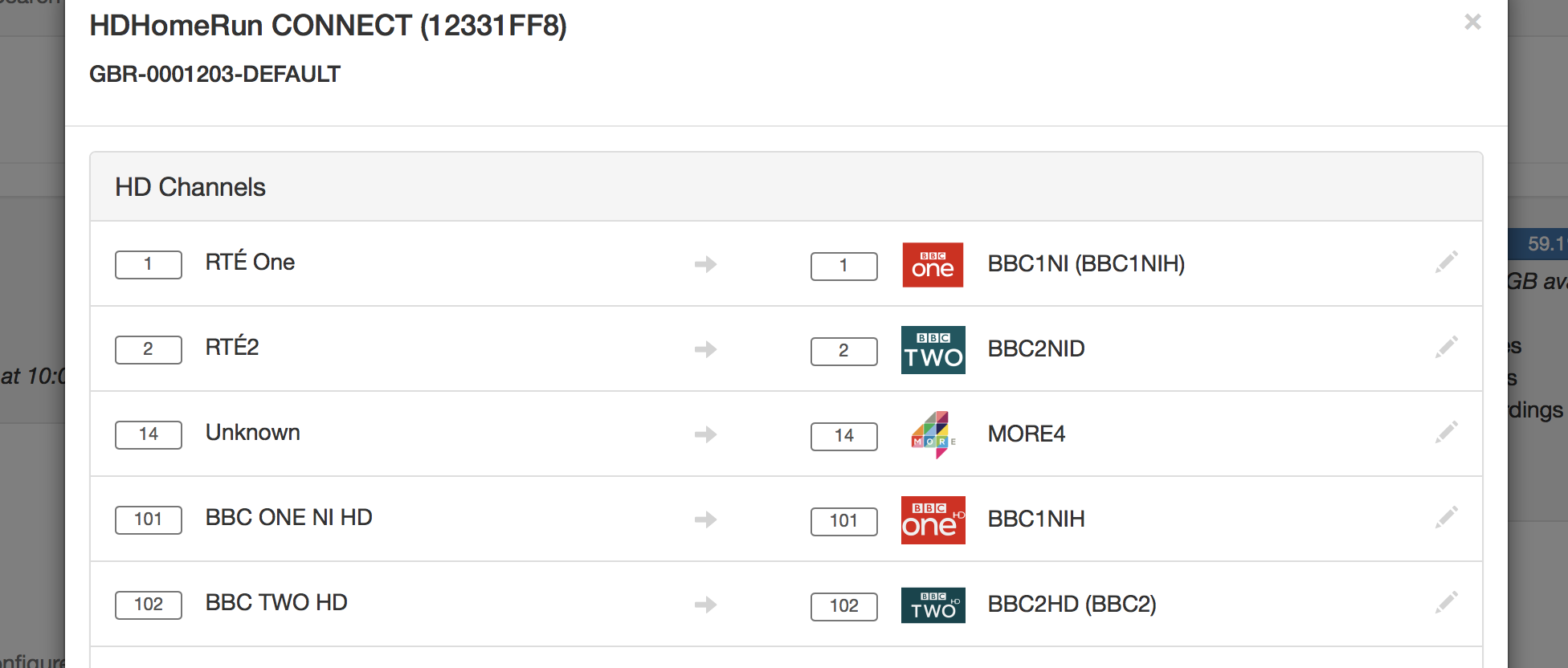

Hi, I hope you can help. I am in Northern Ireland, and the guide for this region picks up two Irish channels (these are legitimately offered as part of the NI freeview broadcast) called RTE1 and RTE2 - they occupy slots 1 and 2, and the DVR guide insists on mapping them to BBC1 and BBC2. When I select them to remap, there are no other options to pick, certainly none for RTE1 and RTE2 ... they're both HD channels - but effectively useless for DVR as they've no guide.
Please see pic - which I hope makes sense.

When you click the pencil icon, can you type in “RT” to bring up better matches?
Hi - when I type RT, no other channels come up at all - there’s no “RTE” in there at all.
What’s the name of the freeview transmitter in your area?
Freeview Limivady is the only N Ireland one that comes up in the list.

Which is fine, but the DVR guide is currently picking them up as channels 1 and 2 in HD.
Hmm, according to that website RTE1 is channel 52. But you’re getting it on channel 1?
Sounds like you’re not receiving Freeview, but Saorview instead. And since the guide data is UK/Freeview, it’s not matching up.
I’ve emailed our guide provider to see what they can do.
Hi
Thank you so much for looking into this. From a big of googling it looks like the DIVIS transmitter has a relay (from SAORVIEW) for RTE1 and RTE HD. In the guide selection there is only one Freeview LIMAVADY for NI, perhaps it might be possible to add DIVIS also?
I’m getting them on Channel 51 and 52 in SD, but on Channels DVR it’s coming up as 1 and 2.
FWIW, I’ve just done a rescan on my Samsung TV, and it is picking them up on channels 861 and 868 both in HD, with full guide info.
Last update on this - but my DVR just failed, or my PC did, not sure, but the channels app on my Apple TV just reverted to non DVR mode with rte 1 and rte 2 in slots 1 and 2 in perfect HD with full programme guide. So the problem is definitely with the guide for the DVR.
I heard back from our provider and they have added these two channels to your lineup, as ch52 and ch53. This will take a day or so to show up.
Once it does, you can use the channel mapper again (via the pencil icon) and then search for RTE to map it to your channel 1 and 2.
