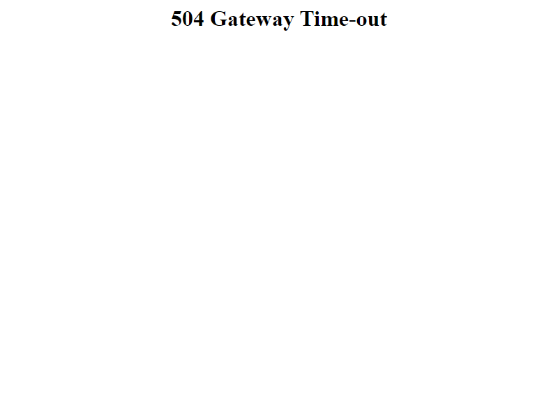

The logs show its trying to use DTV, but when it goes to the TCM website and tries to login with DTV, the DirecTV servers are returning this error:
