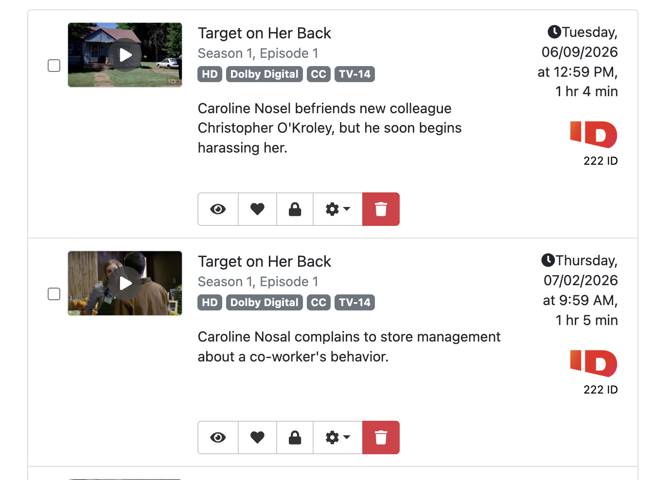

In this example the same episode on same channel was recored on 6/9 and 7/2.

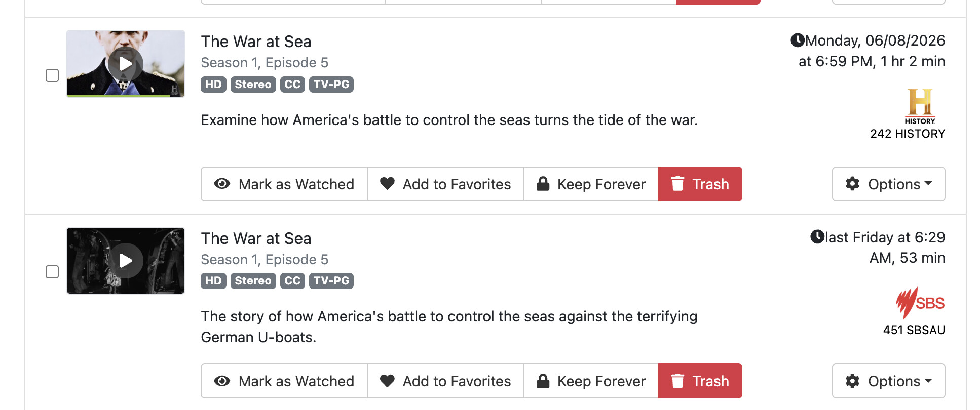

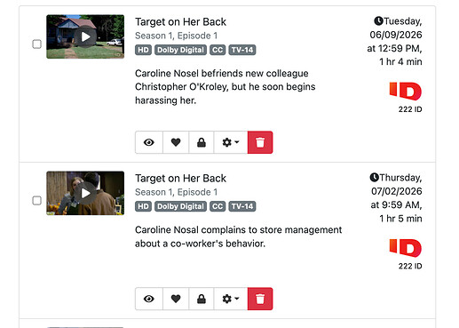

This example happened on 2 different networks, same show.

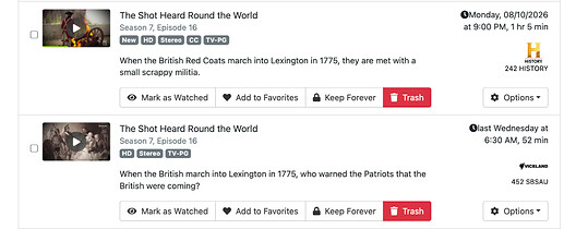

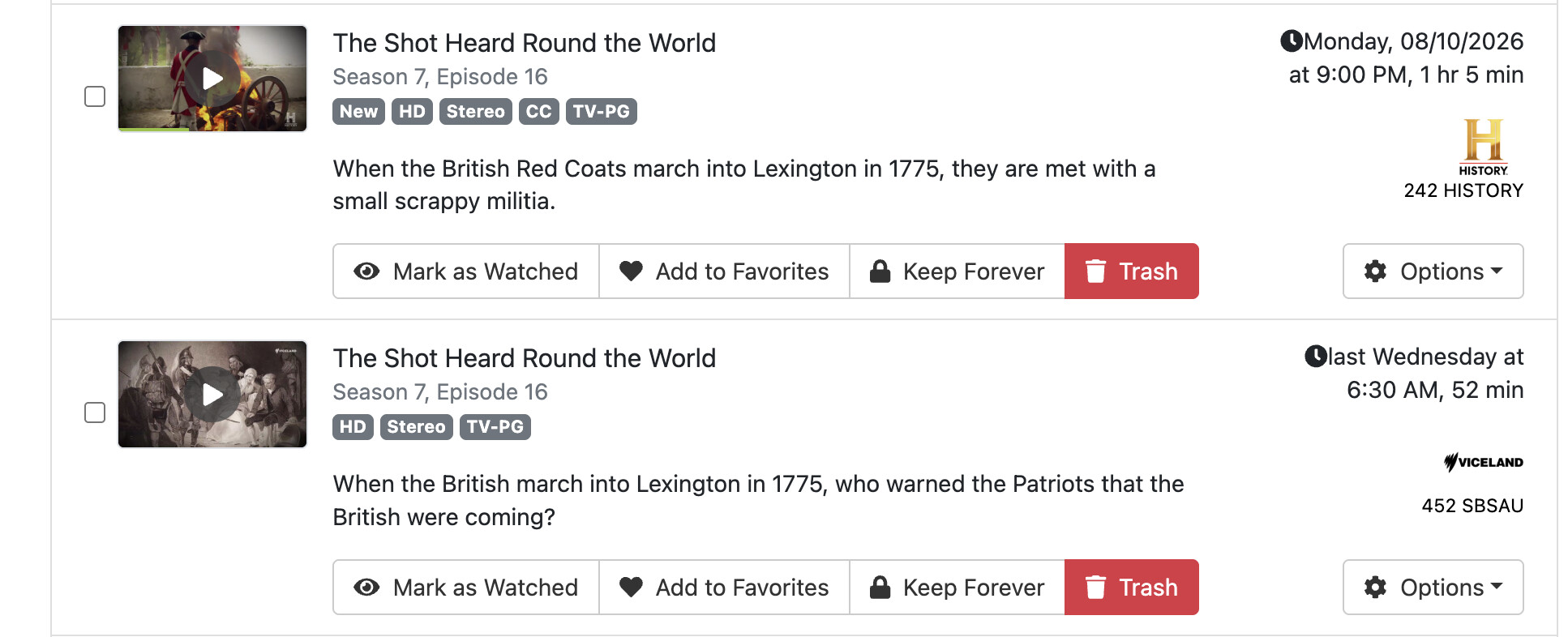

This is another example, notice on this one and the two above, the descriptions are different for the same episode. All Channels are using gracenote ID's and there is no XML guide in place at all.
I submtted diags 17a4b604-b668-454a-8004-6ef63a94aa38
Funny enough, these situations all were due to guide data mismatches between different geographies.
For some reason the second airing of "Target on Her Back" came tagged as the British version of the guide data.
And for the other two, the episode identifiers did not match up between the History channel broadcast and the Australian guide data on the other airings of the other two.
