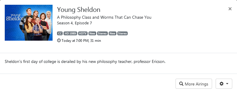

Duplicate tags on TVE recordings

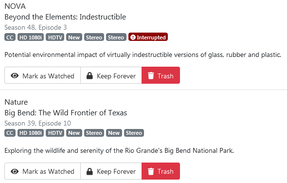

Couple TVE recordings tonight show Stereo Stereo and New Stereo New Stereo
Screenshot_2021-02-10 Channels DVR tags doubled
Is it there twice in the json too?
Yep. v2021.02.09.0017 if it matters.
"Tags": ["CC","HD 1080i","HDTV","New","Stereo","Stereo"],
"Tags": ["CC","HD 1080i","HDTV","New","Stereo","New","Stereo"],

Here's what I find strange. I recorded these on both my Nas's, the one with tag issues was from TVE, the other from HDHR cable as seen here no tag issues

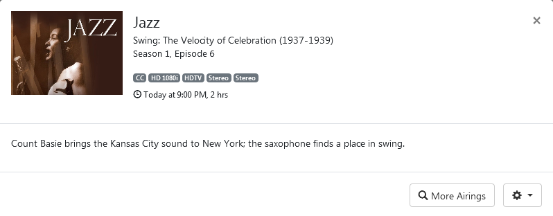

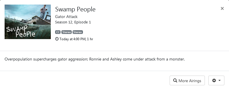

Appears to be a guide issue. Here's a few from todays TVE guide.

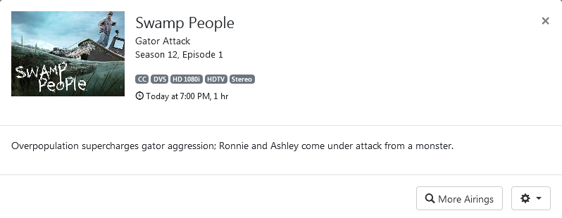

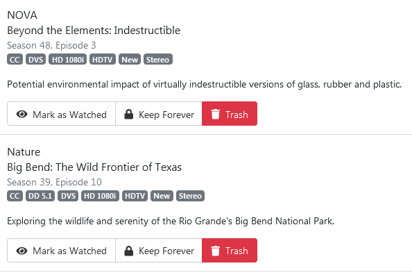

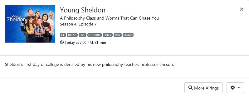

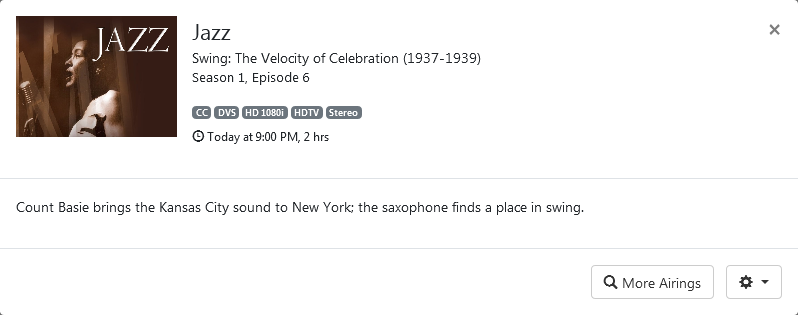

Same ones from guide for my HDHR
Young Sheldon and Jazz are fine on my Locast listings.
So it's obvious something is stripping out the tags DD 5.1 and DVS from TVE schedule info causing the last # of tags listed to duplicate (where # is number of tags removed). This doesn't happen on my HDHR Cable or Locast listings.
Examples;
CC|DVS|HD 1080i|HDTV|Stereo (Original guide info)
CC|HD 1080i|HDTV|Stereo|Stereo (TVE guide info with DVS tag removed)
CC|DD 5.1|DVS|HD 1080i|HDTV|New|Stereo (Original guide info)
CC|HD 1080i|HDTV|New|Stereo|New|Stereo (TVE guide info with DD5.1 and DVS tags removed)
