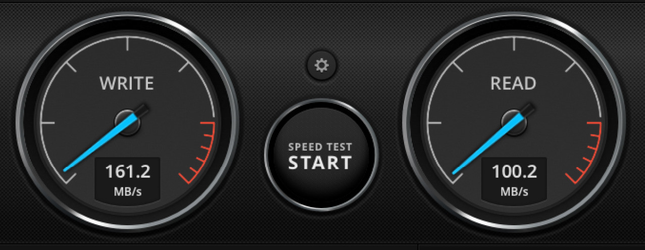

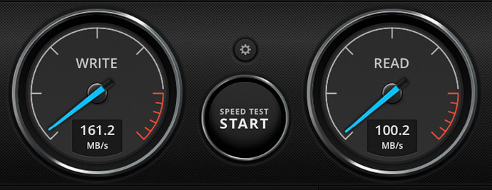

Black Magic speed test seems in spec, too.
Again, just for reference, I scored in the 190's on both Read and Write with Black Magic. I don't know that the difference is significant, but I would think that your Read speeds would be at least equivalent if not higher than Write.

Yep - I'm with you - FWIW that static image wasn't totally representative - it's more equal when running.

Just remembered I have the exact same drive as yours attached to my local machine over standard USB. It is formatted MacOS Extended. Black Magic for Write/Read in this drive was ~ 160/175, respectively.
So, even if this doesn't turn out to be the issue, may be worth looking to get off of ExFAT in the long run to eek out a bit more performance on the drive.
