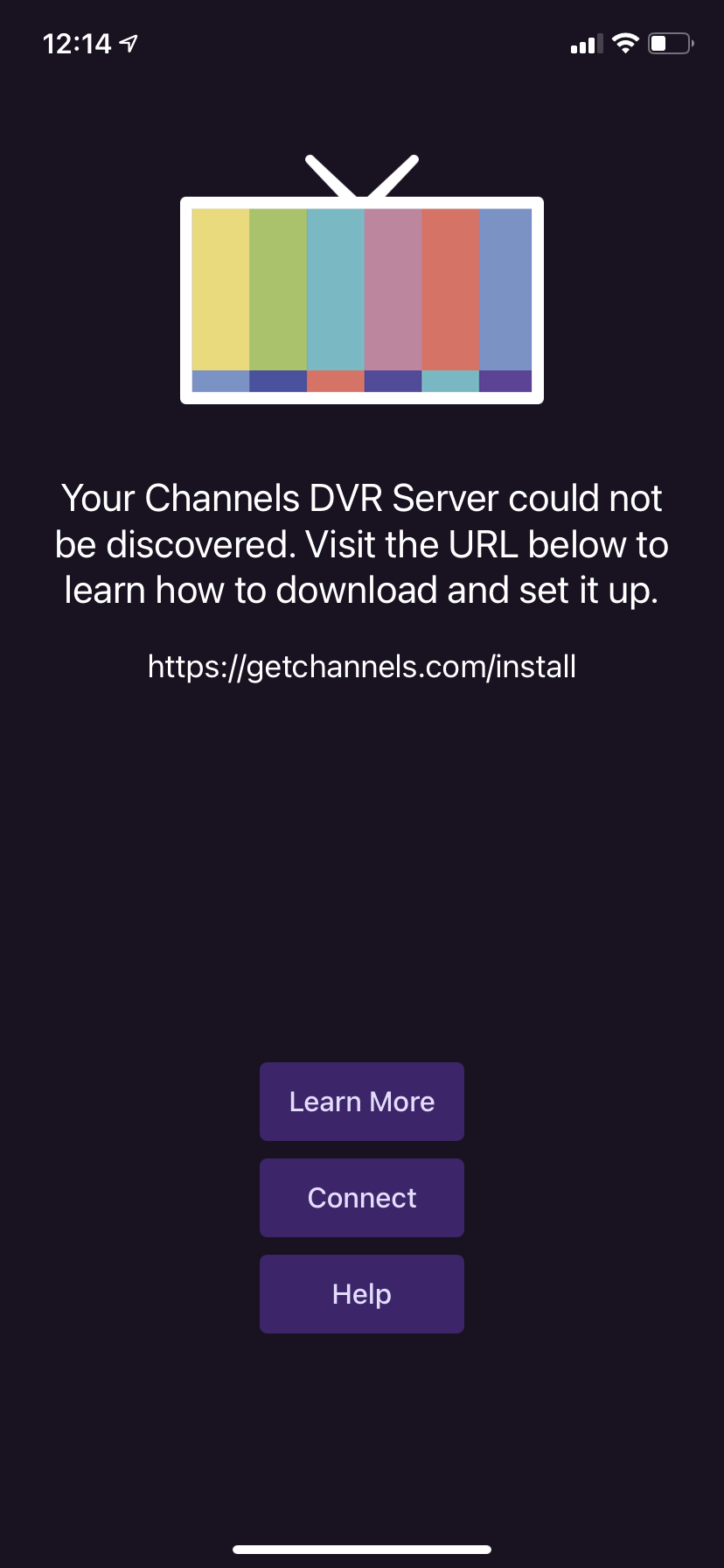

DVR could not be discovered
I have been getting this occasionally from home. I can't figure it out. I did submit diagnostics on my phone when it just happened, but I have seen it before on my hardwired gigabit ATVs.

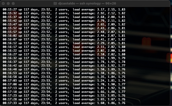

I track load averages every 5 seconds on my NAS running Channels:
I haven't seen it above 4 so I don't think that server load should be an issue.... however, I think that Channels is usually doing something (like recording or comskip) when it happens.
