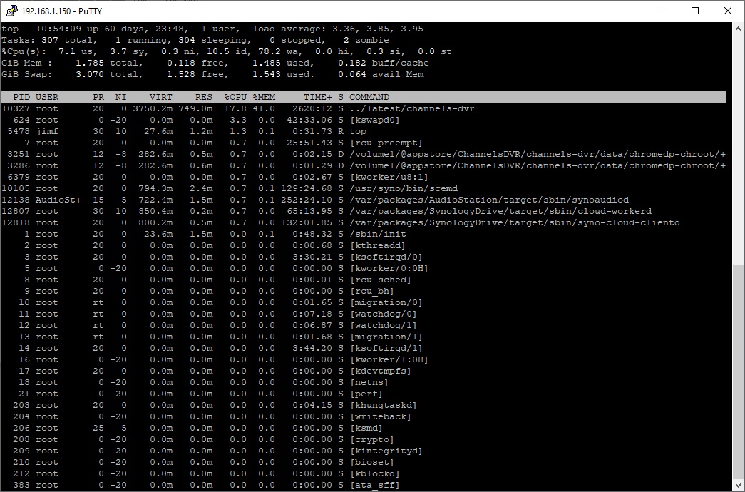

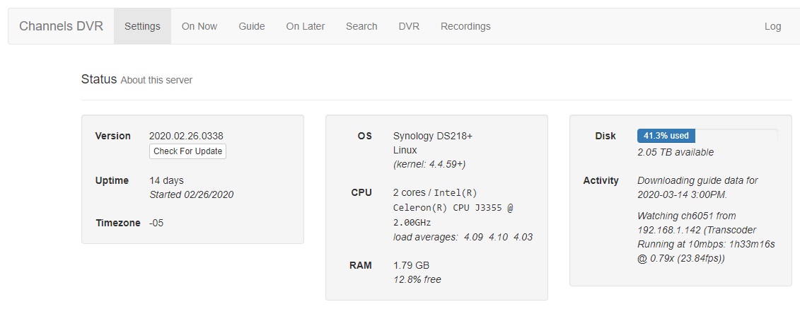

As Channels runs, I notice that it slowly consumes the available system memory. Once free memory gets to below about 40%, things start going bad. CPU utilization gets pegged, the web server becomes sluggish, commercial skipping takes longer to run, guide downloads take hours to perform, etc. Eventually, clients start failing to load (web-based and Fire TV), and scheduled recordings are missed. A reboot sets things straight.
There's nothing in the logs that indicates that anything is wrong. Is there anything else that I should look at? Some (hopefully) relevant screenshots are attached. One thing to note -- the activity showing ch6051 being watched is stale. The stream was shut down approximately 20 minutes prior to the screenshot being taken. Don't know what's up with that...

However, if your NAS is only running Channels and you're concerned about exhausting resources on the device, you may want to stop the other services running on it. For instance, the top view seemed to show both AudioStation and Synology Drive running, the last which is quite resource intensive on the device.
You may want to go through the installed packages and remove everything that isn't necessary, and then disable the un-removable packages.

The hung stream activity in the screenshot was a local web browser (Chrome). All of my local devices (all the Fire TV's) are set to original quality.
FYI -- upon rebooting, available memory was at 78%. Also, performance appears to get particularly bad when retrieving guide updates (9AM local time). I have Locast, 2 TVE providers, and a HDHR as sources. In low memory situations, the guide DL/processing stretches to well over an hour.

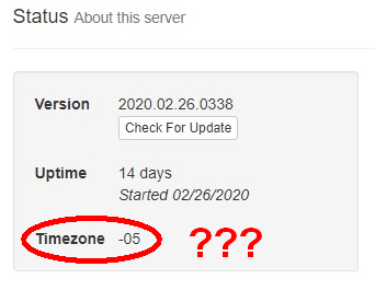

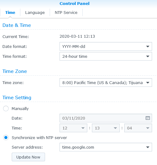

Is your Synology time zone set correctly?
Funny you ask -- it wasn't, but it is now.
I got the 218+ in December, and it was set up as GMT-5 (don't recall how I arrived at that). Anyway, with the time change this past weekend, I noticed it when I SSH'ed into the box. I've since fixed it to be ET.
Anyway, it turns out that Channels actually continued to work properly, even though the system time was wrong. I'm guessing that they use UTC across their guides and recording jobs, etc.
