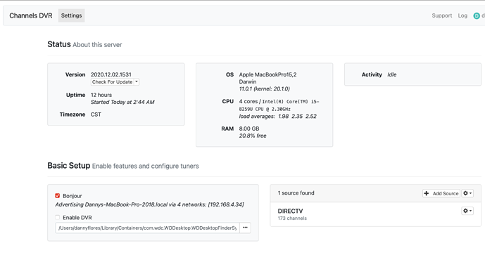

This is what it looks like when Its configured and below I'm attaching the picture of what it looks like after I click configure
Can you click support > Submit Diagnostics at the top right
Does checking the box to the left of DVR in your second screenshot make things work again?
You don't have to click Configure again, just add a bookmark for the page after you get it working.
Ok, I submitted diagnostics, clicking the box does not make the dvr work again, and I'm not sure what you mean with "Add a bookmark" for it to connect to my NAS, I have to disable the channel configuration in my cloud WD page and then enable it again but that deletes everything and it makes me add my direct tv again

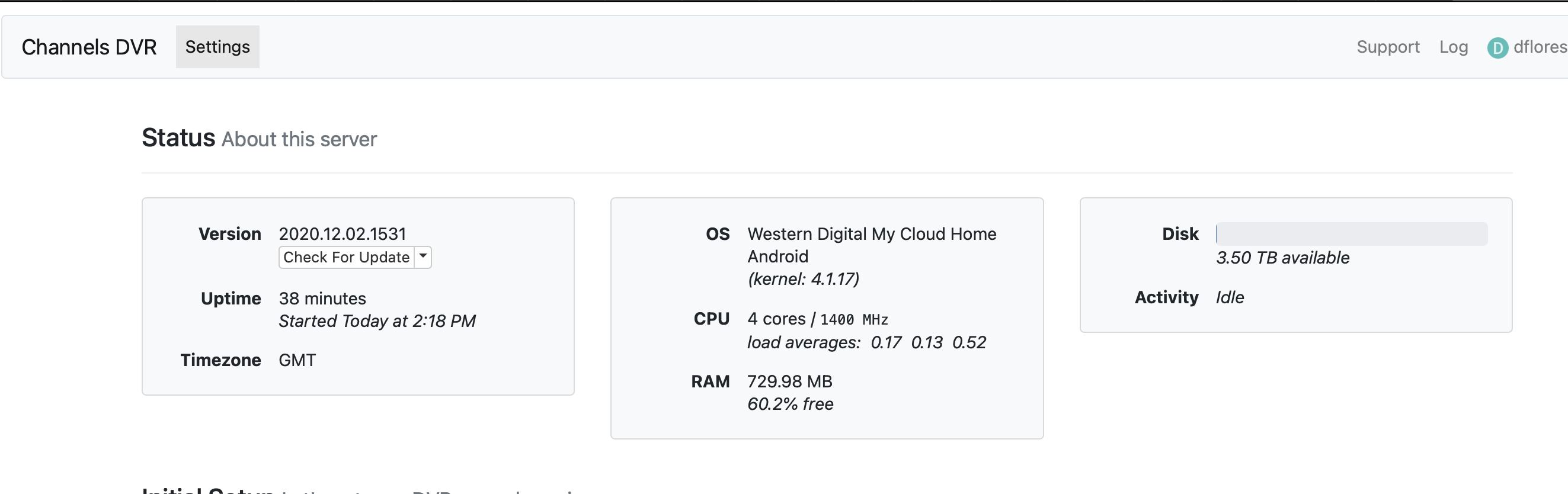

Ok, I uninstalled it then ran the installer and have sent you diagnostics
The diagnostics I got were from your Mac again.
If it's uninstalled now you need to find the dvr web interface on your WD and submit diagnostics from there
Ok, I have done that and sent diagnostics
Okay that came from the right place. So now on that same site go to Settings and finish setup and it should work fine from now on.
