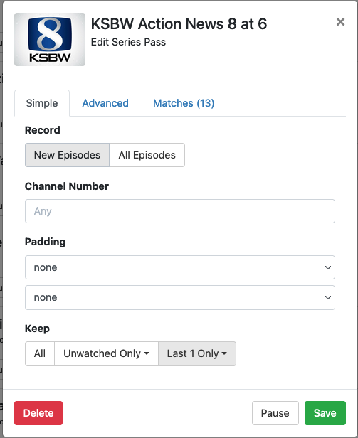

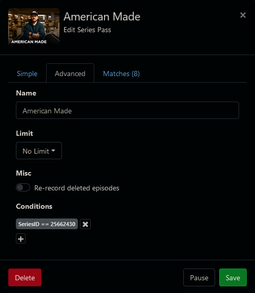

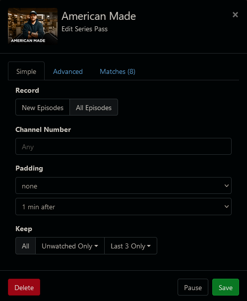

Post an image of your Pass tabs

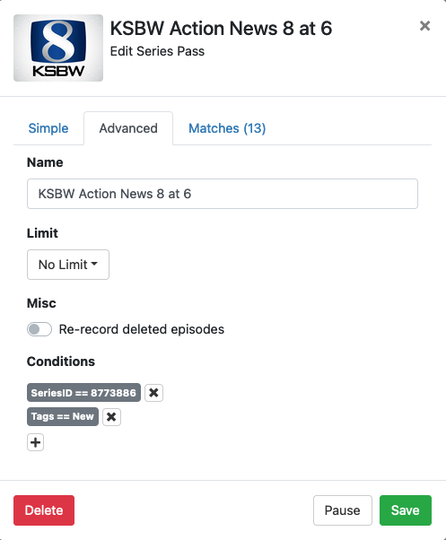

And the Advanced and Matches tabs. You can just edit your post and add them.
Looks like maybe one of the channels don't have the airing marked as "New", but can't tell without the other tabs. And your pass is set to delete all recordings, except for the last one recorded.
Okay, I've added the requested images...don't know what you'll get out of them, but feel free.

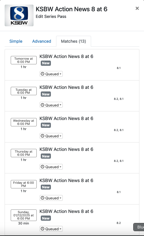

According to the Matches tab, it should record tomorrow on ch 8.1, Tuesday-Thursday on ch 8.2, Friday on ch 8.1 and Sunday on ch 8.2.
To verify this, look at the schedule in the web UI. That is authoritative.
As long as you can receive both 8.1 and 8.2, the web UI schedule should be what records.
If it airs on both 8.1 and 8.2 at the same time, Channels DVR prefers the higher numbered channel first.
You can also change from record new to record all. They will never replay the news but they may forget to add the “new” tag and cause a missed recording.

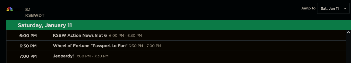

One thing that I see here is that on Saturday, 1/11/25, my guide shows that the news is on 8.1 at 6PM, and the "Matches" view doesn't show that match. That looks like a bug to me.

It's probably not tagged as "New" by the guide provider. Do what @Rice said.
Well, waddayaknow, I changed from "new" to "all", and it added the Saturday, 1/11/25 recording that was missing in the matches. Live and learn.
Thanks!

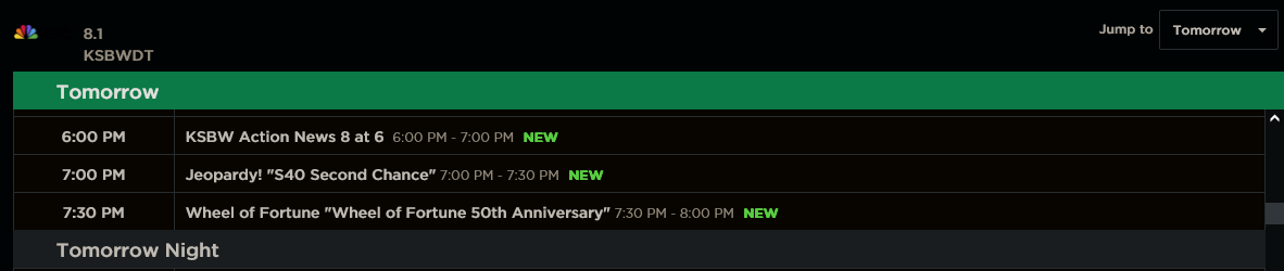

Yup, not listed as "New" at zap2it
But it's "New" tomorrow
