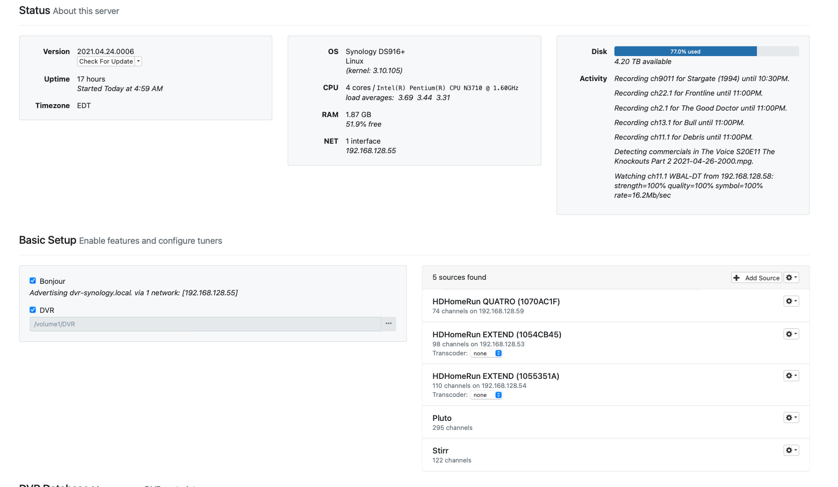

I am running Channels DVR on an older Synology that also runs surveillance on 3 1080p IP camera feeds. I do also use the Synology for network file storage, DSNote, and some small websites. I try not to run much else though. Most other server software I have offloaded to an RPi, including my UniFi controller and the docker containers for Pluto and Stirr.
I have a script that restarts Channels-DVR every day at 4:59AM. And, since the volume is btrfs, I delete home directory snapshots and run a defrag every 6 months or so. All of this fine-tuning took some time to figure out, but would be interested if anyone else running a similar NAS has any other tricks.
