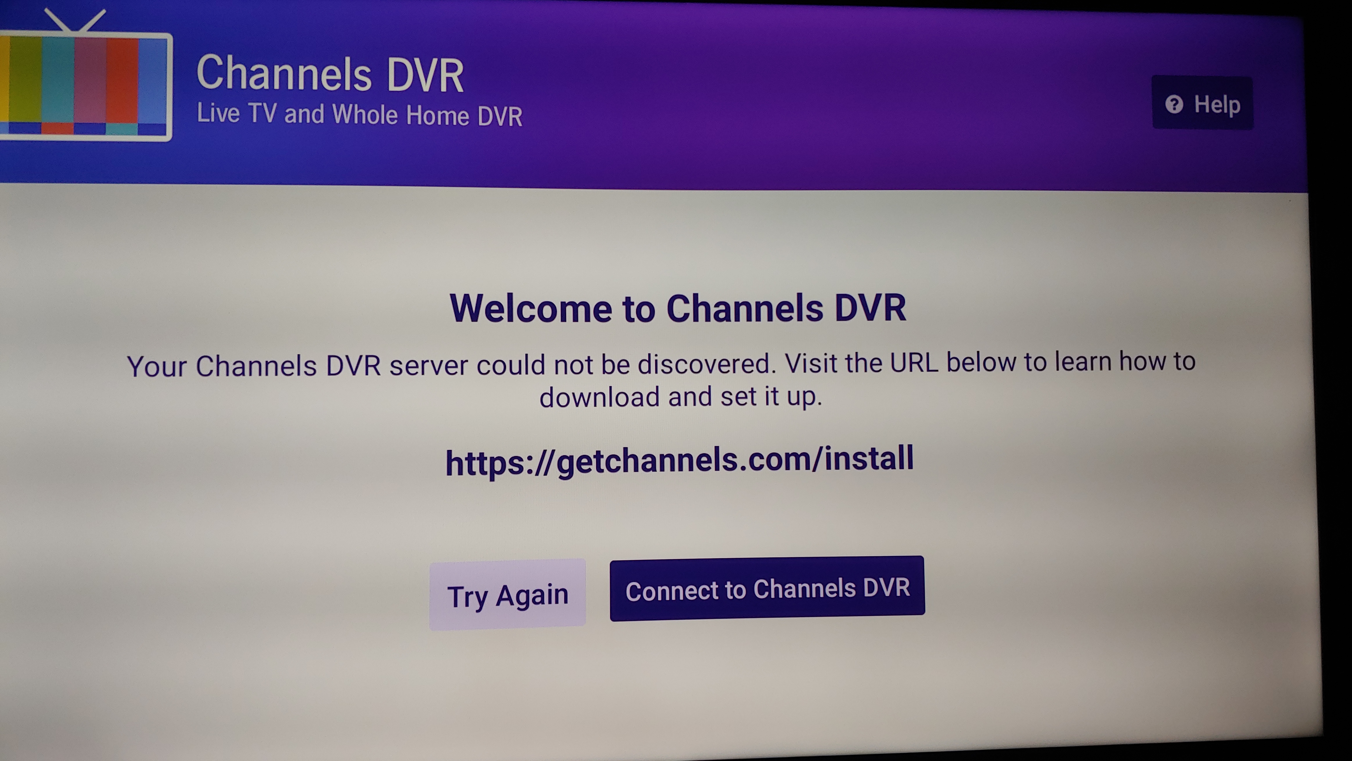

On my Android TV app, everything was working fine then I can't recall what exactly happened but I cleared all the data on the app and have not been able to use the app since.

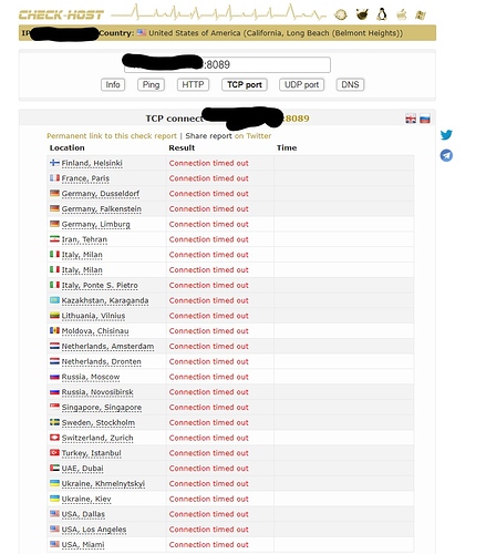

Looks like your router isn’t forwarding the traffic to the DVR server any more. If you didn’t set it to do so manually you might try going into the DVR web console. In the settings area, disable and then re-enable remote access. Worth a shot.

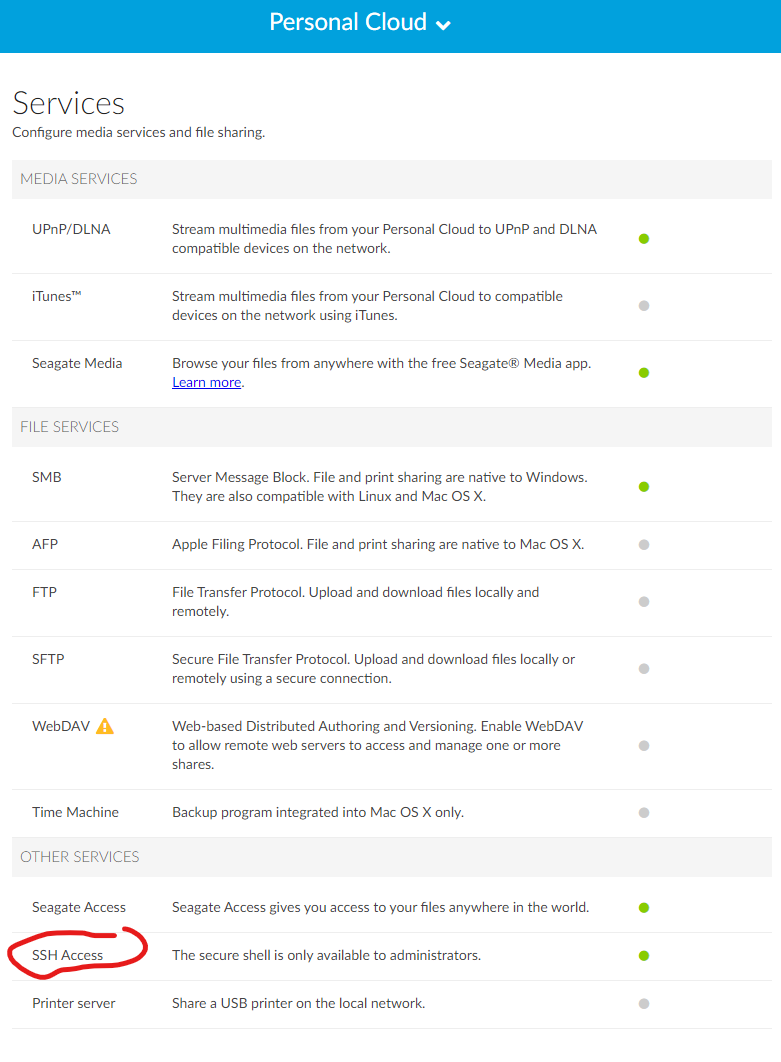

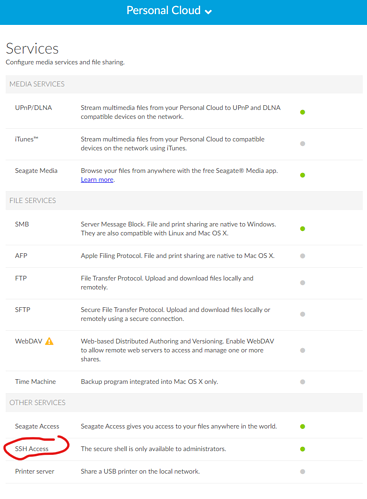

If your question was if SSH is running and working, I'm using putty to restart the HD Home Run DVR each time I reboot the NAS and it works so I guess SSH is on and working. See screenshot as well. Thanks!
Ok great can you paste this command over SSH, then copy/paste the output here:

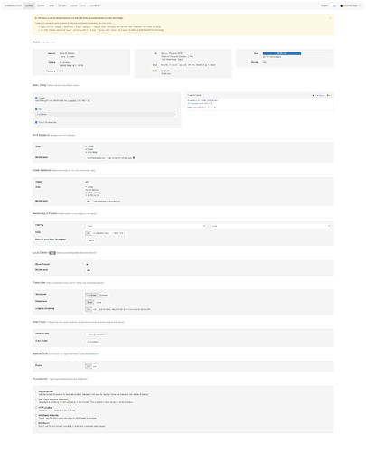

So I set up the DVR temporarily on a PC but do not see the option to restore from a backup. See screenshot of settings page. Any suggestions? Thanks!
Its available on http://x:8089/restore
The DVR checkbox must be unchecked first

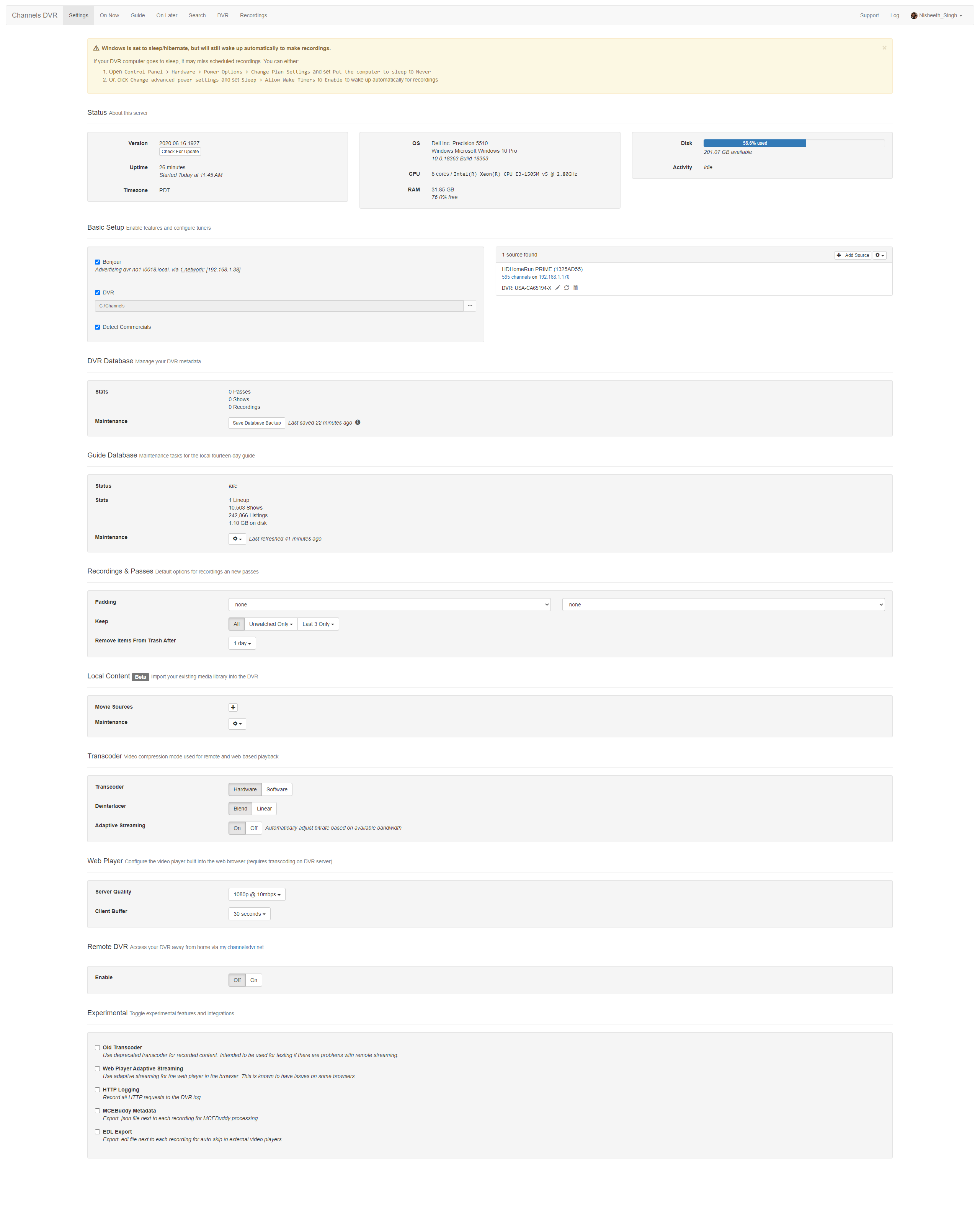

@tmm1 Happy to report all is well now! Successfully uninstalled and reinstalled the app from the NAS. Only question I have is why is my guide not populating, been running for over an hour:
Is guide data set under your HDHR on the settings tab? Try guide refresh from that page.
