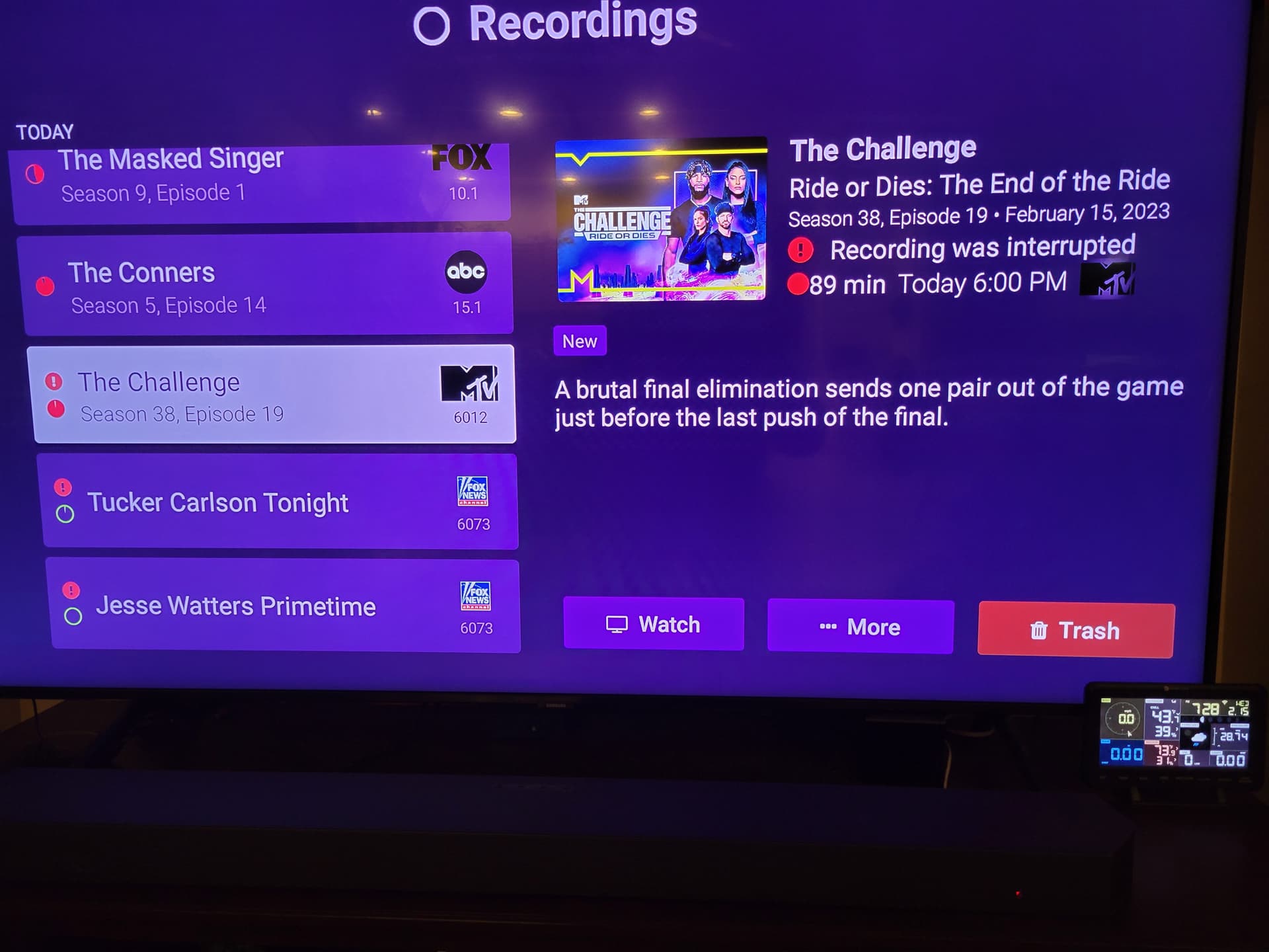

This is a problem I've reported in the past and thought it was only happening with the recording of Fox News programs, but's happened two nights in a row this week, and it's been happening to all of the recordings of shows recorded only from TV Everywhere. All local, OTA programs, record and playback fine.
After this happening the first night, I rebooted my server (QNAP TS-1277 w/AMD Ryzen 5 1600 6-core/12-thread 3.2 GHz processor (Turbo Core to 3.6 GHz)), updated Channels to Version
2023.02.15.0204, and then stopped/restarted Channels on the server for good measure. For the record, we have Cox Gigabit internet service, and have a wired gigabit home network. Last night when we went to watch our recordings, all of the recordings from OTA looked & worked fine, but every recording from our streaming service, Vidgo, all had the 'Recording was interrupted' indicator on them, and while watching, the video, they all randomly fast forward.

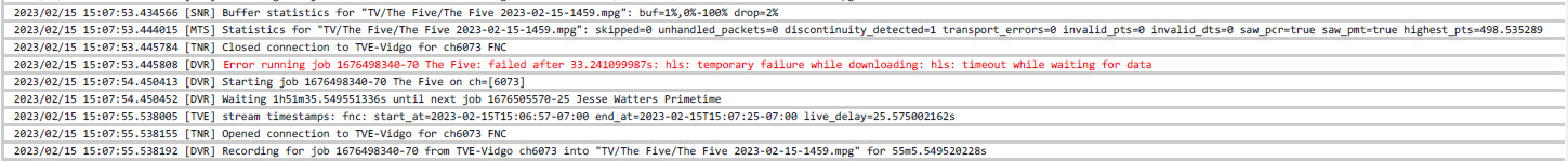

I pulled the log from last night from just before 'The Five' until just after it ended. Like I said, during playback, the video would do a 'fast-forward' skip. I see some 'fails' but I don't know what it means or what caused it.
2023/02/15 14:56:20.821353 [DVR] Waiting 2m39.178650567s until next job 1676498340-70 The Five
2023/02/15 14:59:00.001741 [DVR] Starting job 1676498340-70 The Five on ch=[6073]
2023/02/15 14:59:00.001809 [DVR] Waiting 2h0m29.998196052s until next job 1676505570-25 Jesse Watters Primetime
2023/02/15 14:59:01.103225 [TVE] stream timestamps: fnc: start_at=2023-02-15T14:58:02-07:00 end_at=2023-02-15T14:58:31-07:00 live_delay=25.598222363s
2023/02/15 14:59:01.103354 [TNR] Opened connection to TVE-Vidgo for ch6073 FNC
2023/02/15 14:59:01.143921 [DVR] Recording for job 1676498340-70 from TVE-Vidgo ch6073 into "TV/The Five/The Five 2023-02-15-1459.mpg" for 1h3m59.998161818s
2023/02/15 14:59:01.176413 [IDX] Generating video index for job 1676498340-70
2023/02/15 14:59:34.910355 [SNR] Buffer statistics for "TV/The Five/The Five 2023-02-15-1459.mpg": buf=0% drop=0%
2023/02/15 14:59:34.918892 [MTS] Statistics for "TV/The Five/The Five 2023-02-15-1459.mpg": skipped=0 unhandled_packets=0 discontinuity_detected=0 transport_errors=0 invalid_pts=0 invalid_dts=0 saw_pcr=true saw_pmt=true highest_pts=8.203667
2023/02/15 14:59:34.922292 [TNR] Closed connection to TVE-Vidgo for ch6073 FNC
2023/02/15 14:59:34.922318 [DVR] Error running job 1676498340-70 The Five: failed after 32.786114037s: hls: temporary failure while downloading: hls: timeout while waiting for data
2023/02/15 14:59:35.927968 [DVR] Starting job 1676498340-70 The Five on ch=[6073]
2023/02/15 14:59:35.928013 [DVR] Waiting 1h59m54.071988836s until next job 1676505570-25 Jesse Watters Primetime
2023/02/15 14:59:36.127542 [TVE] stream timestamps: fnc: start_at=2023-02-15T14:58:35-07:00 end_at=2023-02-15T14:59:04-07:00 live_delay=27.854535952s
2023/02/15 14:59:36.127676 [TNR] Opened connection to TVE-Vidgo for ch6073 FNC
2023/02/15 14:59:36.127718 [DVR] Recording for job 1676498340-70 from TVE-Vidgo ch6073 into "TV/The Five/The Five 2023-02-15-1459.mpg" for 1h3m24.07196396s
2023/02/15 14:59:37.201341 [ERR] ULK invalid: {"next_time": -1, "error": "The pt received must be greater than the last received player time (744.0) and less than or equal to the returned next_time (768.0). We received 0.0."}
2023/02/15 15:01:21.129966 [SNR] Buffer statistics for "TV/The Five/The Five 2023-02-15-1459.mpg": buf=0% drop=0%
2023/02/15 15:01:21.137781 [MTS] Statistics for "TV/The Five/The Five 2023-02-15-1459.mpg": skipped=0 unhandled_packets=0 discontinuity_detected=1 transport_errors=0 invalid_pts=0 invalid_dts=0 saw_pcr=true saw_pmt=true highest_pts=81.294722
2023/02/15 15:01:21.139098 [TNR] Closed connection to TVE-Vidgo for ch6073 FNC
2023/02/15 15:01:21.139339 [DVR] Error running job 1676498340-70 The Five: failed after 32.931409084s: hls: temporary failure while downloading: hls: timeout while waiting for data
2023/02/15 15:01:22.144482 [DVR] Starting job 1676498340-70 The Five on ch=[6073]
2023/02/15 15:01:22.144520 [DVR] Waiting 1h58m7.855482787s until next job 1676505570-25 Jesse Watters Primetime
2023/02/15 15:01:22.760154 [TVE] stream timestamps: fnc: start_at=2023-02-15T15:00:24-07:00 end_at=2023-02-15T15:00:53-07:00 live_delay=25.580150938s
2023/02/15 15:01:22.760265 [TNR] Opened connection to TVE-Vidgo for ch6073 FNC
2023/02/15 15:01:22.760301 [DVR] Recording for job 1676498340-70 from TVE-Vidgo ch6073 into "TV/The Five/The Five 2023-02-15-1459.mpg" for 1h1m37.855455806s
2023/02/15 15:07:53.434566 [SNR] Buffer statistics for "TV/The Five/The Five 2023-02-15-1459.mpg": buf=1%,0%-100% drop=2%
2023/02/15 15:07:53.444015 [MTS] Statistics for "TV/The Five/The Five 2023-02-15-1459.mpg": skipped=0 unhandled_packets=0 discontinuity_detected=1 transport_errors=0 invalid_pts=0 invalid_dts=0 saw_pcr=true saw_pmt=true highest_pts=498.535289
2023/02/15 15:07:53.445784 [TNR] Closed connection to TVE-Vidgo for ch6073 FNC
2023/02/15 15:07:53.445808 [DVR] Error running job 1676498340-70 The Five: failed after 33.241099987s: hls: temporary failure while downloading: hls: timeout while waiting for data
2023/02/15 15:07:54.450413 [DVR] Starting job 1676498340-70 The Five on ch=[6073]
2023/02/15 15:07:54.450452 [DVR] Waiting 1h51m35.549551336s until next job 1676505570-25 Jesse Watters Primetime
2023/02/15 15:07:55.538005 [TVE] stream timestamps: fnc: start_at=2023-02-15T15:06:57-07:00 end_at=2023-02-15T15:07:25-07:00 live_delay=25.575002162s
2023/02/15 15:07:55.538155 [TNR] Opened connection to TVE-Vidgo for ch6073 FNC
2023/02/15 15:07:55.538192 [DVR] Recording for job 1676498340-70 from TVE-Vidgo ch6073 into "TV/The Five/The Five 2023-02-15-1459.mpg" for 55m5.549520228s
2023/02/15 15:10:24.772441 [SNR] Buffer statistics for "TV/The Five/The Five 2023-02-15-1459.mpg": buf=0% drop=0%
2023/02/15 15:10:24.781220 [MTS] Statistics for "TV/The Five/The Five 2023-02-15-1459.mpg": skipped=0 unhandled_packets=0 discontinuity_detected=0 transport_errors=0 invalid_pts=0 invalid_dts=0 saw_pcr=true saw_pmt=true highest_pts=657.343344
2023/02/15 15:10:24.784892 [TNR] Closed connection to TVE-Vidgo for ch6073 FNC
2023/02/15 15:10:24.784912 [DVR] Error running job 1676498340-70 The Five: failed after 33.157324915s: hls: temporary failure while downloading: hls: timeout while waiting for data
2023/02/15 15:10:25.789033 [DVR] Starting job 1676498340-70 The Five on ch=[6073]
2023/02/15 15:10:25.789065 [DVR] Waiting 1h49m4.210937302s until next job 1676505570-25 Jesse Watters Primetime
2023/02/15 15:10:26.551599 [TVE] stream timestamps: fnc: start_at=2023-02-15T15:09:28-07:00 end_at=2023-02-15T15:09:56-07:00 live_delay=25.560597192s
2023/02/15 15:10:26.551697 [TNR] Opened connection to TVE-Vidgo for ch6073 FNC
2023/02/15 15:10:26.551734 [DVR] Recording for job 1676498340-70 from TVE-Vidgo ch6073 into "TV/The Five/The Five 2023-02-15-1459.mpg" for 52m34.210911233s
2023/02/15 15:11:43.849813 [SNR] Buffer statistics for "TV/The Five/The Five 2023-02-15-1459.mpg": buf=0% drop=0%
2023/02/15 15:11:43.858749 [MTS] Statistics for "TV/The Five/The Five 2023-02-15-1459.mpg": skipped=0 unhandled_packets=0 discontinuity_detected=0 transport_errors=0 invalid_pts=0 invalid_dts=0 saw_pcr=true saw_pmt=true highest_pts=734.957700
2023/02/15 15:11:43.859609 [TNR] Closed connection to TVE-Vidgo for ch6073 FNC
2023/02/15 15:11:43.859630 [DVR] Error running job 1676498340-70 The Five: failed after 33.21514993s: hls: temporary failure while downloading: hls: timeout while waiting for data
2023/02/15 15:11:44.864157 [DVR] Starting job 1676498340-70 The Five on ch=[6073]
2023/02/15 15:11:44.864188 [DVR] Waiting 1h47m45.135813304s until next job 1676505570-25 Jesse Watters Primetime
2023/02/15 15:11:46.506888 [TVE] stream timestamps: fnc: start_at=2023-02-15T15:10:47-07:00 end_at=2023-02-15T15:11:17-07:00 live_delay=26.551884917s
2023/02/15 15:11:46.507032 [TNR] Opened connection to TVE-Vidgo for ch6073 FNC
2023/02/15 15:11:46.507076 [DVR] Recording for job 1676498340-70 from TVE-Vidgo ch6073 into "TV/The Five/The Five 2023-02-15-1459.mpg" for 51m15.135789349s
2023/02/15 15:17:10.393363 [SNR] Buffer statistics for "TV/The Five/The Five 2023-02-15-1459.mpg": buf=0% drop=0%
2023/02/15 15:17:10.402562 [MTS] Statistics for "TV/The Five/The Five 2023-02-15-1459.mpg": skipped=0 unhandled_packets=0 discontinuity_detected=34 transport_errors=0 invalid_pts=0 invalid_dts=0 saw_pcr=true saw_pmt=true highest_pts=1059.351889
2023/02/15 15:17:10.405645 [TNR] Closed connection to TVE-Vidgo for ch6073 FNC
2023/02/15 15:17:10.405667 [DVR] Error running job 1676498340-70 The Five: failed after 33.087720195s: hls: temporary failure while downloading: hls: timeout while waiting for data
2023/02/15 15:17:11.411618 [DVR] Starting job 1676498340-70 The Five on ch=[6073]
2023/02/15 15:17:11.411648 [DVR] Waiting 1h42m18.588353764s until next job 1676505570-25 Jesse Watters Primetime
2023/02/15 15:17:13.381924 [TVE] stream timestamps: fnc: start_at=2023-02-15T15:16:15-07:00 end_at=2023-02-15T15:16:43-07:00 live_delay=25.525921099s
2023/02/15 15:17:13.382030 [TNR] Opened connection to TVE-Vidgo for ch6073 FNC
2023/02/15 15:17:13.382059 [DVR] Recording for job 1676498340-70 from TVE-Vidgo ch6073 into "TV/The Five/The Five 2023-02-15-1459.mpg" for 45m48.588329278s
2023/02/15 15:17:47.287849 [SNR] Buffer statistics for "TV/The Five/The Five 2023-02-15-1459.mpg": buf=0% drop=0%
2023/02/15 15:17:47.296692 [MTS] Statistics for "TV/The Five/The Five 2023-02-15-1459.mpg": skipped=0 unhandled_packets=0 discontinuity_detected=0 transport_errors=0 invalid_pts=0 invalid_dts=0 saw_pcr=true saw_pmt=true highest_pts=1099.609767
2023/02/15 15:17:47.298508 [TNR] Closed connection to TVE-Vidgo for ch6073 FNC
2023/02/15 15:17:47.298528 [DVR] Error running job 1676498340-70 The Five: failed after 32.740360414s: hls: temporary failure while downloading: hls: timeout while waiting for data
2023/02/15 15:17:48.304542 [DVR] Starting job 1676498340-70 The Five on ch=[6073]
2023/02/15 15:17:48.304572 [DVR] Waiting 1h41m41.695429158s until next job 1676505570-25 Jesse Watters Primetime
2023/02/15 15:17:48.515035 [TVE] stream timestamps: fnc: start_at=2023-02-15T15:16:47-07:00 end_at=2023-02-15T15:17:16-07:00 live_delay=27.89102938s
2023/02/15 15:17:48.515215 [TNR] Opened connection to TVE-Vidgo for ch6073 FNC
2023/02/15 15:17:48.515253 [DVR] Recording for job 1676498340-70 from TVE-Vidgo ch6073 into "TV/The Five/The Five 2023-02-15-1459.mpg" for 45m11.695403379s
2023/02/15 15:17:49.547574 [ERR] ULK invalid: {"next_time": -1, "error": "The pt received must be greater than the last received player time (744.0) and less than or equal to the returned next_time (768.0). We received 0.0."}
2023/02/15 15:22:01.857337 [SNR] Buffer statistics for "TV/The Five/The Five 2023-02-15-1459.mpg": buf=3%,0%-100% drop=4%
2023/02/15 15:22:01.867972 [MTS] Statistics for "TV/The Five/The Five 2023-02-15-1459.mpg": skipped=0 unhandled_packets=0 discontinuity_detected=3 transport_errors=0 invalid_pts=0 invalid_dts=0 saw_pcr=true saw_pmt=true highest_pts=1337.259411
2023/02/15 15:22:01.871364 [TNR] Closed connection to TVE-Vidgo for ch6073 FNC
2023/02/15 15:22:01.871384 [DVR] Error running job 1676498340-70 The Five: failed after 33.21532538s: hls: temporary failure while downloading: hls: timeout while waiting for data
2023/02/15 15:22:02.875269 [DVR] Starting job 1676498340-70 The Five on ch=[6073]
2023/02/15 15:22:02.875304 [DVR] Waiting 1h37m27.12469771s until next job 1676505570-25 Jesse Watters Primetime
2023/02/15 15:22:03.922061 [TVE] stream timestamps: fnc: start_at=2023-02-15T15:21:05-07:00 end_at=2023-02-15T15:21:34-07:00 live_delay=25.604058182s
2023/02/15 15:22:03.922169 [TNR] Opened connection to TVE-Vidgo for ch6073 FNC
2023/02/15 15:22:03.922204 [DVR] Recording for job 1676498340-70 from TVE-Vidgo ch6073 into "TV/The Five/The Five 2023-02-15-1459.mpg" for 40m57.12467091s
2023/02/15 15:22:56.936273 [SNR] Buffer statistics for "TV/The Five/The Five 2023-02-15-1459.mpg": buf=0% drop=0%
2023/02/15 15:22:56.945453 [MTS] Statistics for "TV/The Five/The Five 2023-02-15-1459.mpg": skipped=0 unhandled_packets=0 discontinuity_detected=0 transport_errors=0 invalid_pts=0 invalid_dts=0 saw_pcr=true saw_pmt=true highest_pts=1407.456211
2023/02/15 15:22:56.949302 [TNR] Closed connection to TVE-Vidgo for ch6073 FNC
2023/02/15 15:22:56.949328 [DVR] Error running job 1676498340-70 The Five: failed after 32.866149984s: hls: temporary failure while downloading: hls: timeout while waiting for data
2023/02/15 15:22:57.953847 [DVR] Starting job 1676498340-70 The Five on ch=[6073]
2023/02/15 15:22:57.953880 [DVR] Waiting 1h36m32.046121663s until next job 1676505570-25 Jesse Watters Primetime
2023/02/15 15:22:58.690490 [TVE] stream timestamps: fnc: start_at=2023-02-15T15:22:00-07:00 end_at=2023-02-15T15:22:28-07:00 live_delay=25.61648656s
2023/02/15 15:22:58.690619 [TNR] Opened connection to TVE-Vidgo for ch6073 FNC
2023/02/15 15:22:58.690652 [DVR] Recording for job 1676498340-70 from TVE-Vidgo ch6073 into "TV/The Five/The Five 2023-02-15-1459.mpg" for 40m2.046098469s
2023/02/15 15:30:36.215541 [SNR] Buffer statistics for "TV/The Five/The Five 2023-02-15-1459.mpg": buf=1%,0%-100% drop=2%
2023/02/15 15:30:36.222939 [MTS] Statistics for "TV/The Five/The Five 2023-02-15-1459.mpg": skipped=0 unhandled_packets=0 discontinuity_detected=51 transport_errors=0 invalid_pts=0 invalid_dts=0 saw_pcr=true saw_pmt=true highest_pts=1856.344133
2023/02/15 15:30:36.226601 [TNR] Closed connection to TVE-Vidgo for ch6073 FNC
2023/02/15 15:30:36.226626 [DVR] Error running job 1676498340-70 The Five: failed after 30.691669824s: hls: temporary failure while downloading: hls: timeout while waiting for data
2023/02/15 15:30:37.233048 [DVR] Starting job 1676498340-70 The Five on ch=[6073]
2023/02/15 15:30:37.233082 [DVR] Waiting 1h28m52.766920224s until next job 1676505570-25 Jesse Watters Primetime
2023/02/15 15:30:39.692214 [TVE] stream timestamps: fnc: start_at=2023-02-15T15:29:41-07:00 end_at=2023-02-15T15:30:10-07:00 live_delay=25.493209728s
2023/02/15 15:30:39.692359 [TNR] Opened connection to TVE-Vidgo for ch6073 FNC
2023/02/15 15:30:39.692399 [DVR] Recording for job 1676498340-70 from TVE-Vidgo ch6073 into "TV/The Five/The Five 2023-02-15-1459.mpg" for 32m22.76689686s
2023/02/15 15:32:07.027611 [SNR] Buffer statistics for "TV/The Five/The Five 2023-02-15-1459.mpg": buf=0% drop=0%
2023/02/15 15:32:07.036361 [MTS] Statistics for "TV/The Five/The Five 2023-02-15-1459.mpg": skipped=0 unhandled_packets=0 discontinuity_detected=0 transport_errors=0 invalid_pts=0 invalid_dts=0 saw_pcr=true saw_pmt=true highest_pts=1958.675867
2023/02/15 15:32:07.037007 [TNR] Closed connection to TVE-Vidgo for ch6073 FNC
2023/02/15 15:32:07.037024 [DVR] Error running job 1676498340-70 The Five: failed after 31.253881983s: hls: temporary failure while downloading: hls: timeout while waiting for data
2023/02/15 15:32:08.041928 [DVR] Starting job 1676498340-70 The Five on ch=[6073]
2023/02/15 15:32:08.041955 [DVR] Waiting 1h27m21.958046127s until next job 1676505570-25 Jesse Watters Primetime
2023/02/15 15:32:09.060581 [TVE] stream timestamps: fnc: start_at=2023-02-15T15:31:10-07:00 end_at=2023-02-15T15:31:39-07:00 live_delay=25.488577967s
2023/02/15 15:32:09.060692 [TNR] Opened connection to TVE-Vidgo for ch6073 FNC
2023/02/15 15:32:09.060732 [DVR] Recording for job 1676498340-70 from TVE-Vidgo ch6073 into "TV/The Five/The Five 2023-02-15-1459.mpg" for 30m51.958020088s
2023/02/15 15:33:20.834401 [SNR] Buffer statistics for "TV/The Five/The Five 2023-02-15-1459.mpg": buf=2%,0%-100% drop=3%
2023/02/15 15:33:20.844236 [MTS] Statistics for "TV/The Five/The Five 2023-02-15-1459.mpg": skipped=0 unhandled_packets=0 discontinuity_detected=0 transport_errors=0 invalid_pts=0 invalid_dts=0 saw_pcr=true saw_pmt=true highest_pts=2029.017078
2023/02/15 15:33:20.845777 [TNR] Closed connection to TVE-Vidgo for ch6073 FNC
2023/02/15 15:33:20.845795 [DVR] Error running job 1676498340-70 The Five: failed after 35.701316617s: hls: temporary failure while downloading: hls: timeout while waiting for data
2023/02/15 15:33:21.849979 [DVR] Starting job 1676498340-70 The Five on ch=[6073]
2023/02/15 15:33:21.850008 [DVR] Waiting 1h26m8.149993157s until next job 1676505570-25 Jesse Watters Primetime
2023/02/15 15:33:22.487582 [TVE] stream timestamps: fnc: start_at=2023-02-15T15:32:24-07:00 end_at=2023-02-15T15:32:52-07:00 live_delay=25.475578859s
2023/02/15 15:33:22.487718 [TNR] Opened connection to TVE-Vidgo for ch6073 FNC
2023/02/15 15:33:22.487755 [DVR] Recording for job 1676498340-70 from TVE-Vidgo ch6073 into "TV/The Five/The Five 2023-02-15-1459.mpg" for 29m38.149969262s
2023/02/15 15:35:31.656259 [SNR] Buffer statistics for "TV/The Five/The Five 2023-02-15-1459.mpg": buf=0% drop=0%
2023/02/15 15:35:31.666588 [MTS] Statistics for "TV/The Five/The Five 2023-02-15-1459.mpg": skipped=0 unhandled_packets=0 discontinuity_detected=0 transport_errors=0 invalid_pts=0 invalid_dts=0 saw_pcr=true saw_pmt=true highest_pts=2164.257389
2023/02/15 15:35:31.670259 [TNR] Closed connection to TVE-Vidgo for ch6073 FNC
2023/02/15 15:35:31.670292 [DVR] Error running job 1676498340-70 The Five: failed after 33.094153141s: hls: temporary failure while downloading: hls: timeout while waiting for data
2023/02/15 15:35:32.674834 [DVR] Starting job 1676498340-70 The Five on ch=[6073]
2023/02/15 15:35:32.674862 [DVR] Waiting 1h23m57.325139715s until next job 1676505570-25 Jesse Watters Primetime
2023/02/15 15:35:33.442514 [TVE] stream timestamps: fnc: start_at=2023-02-15T15:34:35-07:00 end_at=2023-02-15T15:35:03-07:00 live_delay=25.492510735s
2023/02/15 15:35:33.442637 [TNR] Opened connection to TVE-Vidgo for ch6073 FNC
2023/02/15 15:35:33.442668 [DVR] Recording for job 1676498340-70 from TVE-Vidgo ch6073 into "TV/The Five/The Five 2023-02-15-1459.mpg" for 27m27.325114868s
2023/02/15 15:41:20.210367 [SNR] Buffer statistics for "TV/The Five/The Five 2023-02-15-1459.mpg": buf=0%-100% drop=0.58%
2023/02/15 15:41:20.217906 [MTS] Statistics for "TV/The Five/The Five 2023-02-15-1459.mpg": skipped=0 unhandled_packets=0 discontinuity_detected=47 transport_errors=0 invalid_pts=0 invalid_dts=0 saw_pcr=true saw_pmt=true highest_pts=2513.351567
2023/02/15 15:41:20.220682 [TNR] Closed connection to TVE-Vidgo for ch6073 FNC
2023/02/15 15:41:20.220703 [DVR] Error running job 1676498340-70 The Five: failed after 33.323400823s: hls: temporary failure while downloading: hls: timeout while waiting for data
2023/02/15 15:41:21.224513 [DVR] Starting job 1676498340-70 The Five on ch=[6073]
2023/02/15 15:41:21.224550 [DVR] Waiting 1h18m8.775453322s until next job 1676505570-25 Jesse Watters Primetime
2023/02/15 15:41:22.406567 [TVE] stream timestamps: fnc: start_at=2023-02-15T15:40:24-07:00 end_at=2023-02-15T15:40:52-07:00 live_delay=25.455563396s
2023/02/15 15:41:22.406694 [TNR] Opened connection to TVE-Vidgo for ch6073 FNC
2023/02/15 15:41:22.406738 [DVR] Recording for job 1676498340-70 from TVE-Vidgo ch6073 into "TV/The Five/The Five 2023-02-15-1459.mpg" for 21m38.775426151s
2023/02/15 15:44:11.633604 [SNR] Buffer statistics for "TV/The Five/The Five 2023-02-15-1459.mpg": buf=0% drop=0%
2023/02/15 15:44:11.641127 [MTS] Statistics for "TV/The Five/The Five 2023-02-15-1459.mpg": skipped=0 unhandled_packets=0 discontinuity_detected=0 transport_errors=0 invalid_pts=0 invalid_dts=0 saw_pcr=true saw_pmt=true highest_pts=2684.585689
2023/02/15 15:44:11.646296 [TNR] Closed connection to TVE-Vidgo for ch6073 FNC
2023/02/15 15:44:11.646321 [DVR] Error running job 1676498340-70 The Five: failed after 33.147226613s: hls: temporary failure while downloading: hls: timeout while waiting for data
2023/02/15 15:44:12.650930 [DVR] Starting job 1676498340-70 The Five on ch=[6073]
2023/02/15 15:44:12.650969 [DVR] Waiting 1h15m17.34903361s until next job 1676505570-25 Jesse Watters Primetime
2023/02/15 15:44:13.276444 [TVE] stream timestamps: fnc: start_at=2023-02-15T15:43:15-07:00 end_at=2023-02-15T15:43:43-07:00 live_delay=25.454440894s
2023/02/15 15:44:13.276647 [TNR] Opened connection to TVE-Vidgo for ch6073 FNC
2023/02/15 15:44:13.276693 [DVR] Recording for job 1676498340-70 from TVE-Vidgo ch6073 into "TV/The Five/The Five 2023-02-15-1459.mpg" for 18m47.34900173s
2023/02/15 15:46:05.541676 [SNR] Buffer statistics for "TV/The Five/The Five 2023-02-15-1459.mpg": buf=0% drop=0%
2023/02/15 15:46:05.553152 [MTS] Statistics for "TV/The Five/The Five 2023-02-15-1459.mpg": skipped=0 unhandled_packets=0 discontinuity_detected=0 transport_errors=0 invalid_pts=0 invalid_dts=0 saw_pcr=true saw_pmt=true highest_pts=2798.678022
2023/02/15 15:46:05.555880 [TNR] Closed connection to TVE-Vidgo for ch6073 FNC
2023/02/15 15:46:05.555907 [DVR] Error running job 1676498340-70 The Five: failed after 32.199876983s: hls: temporary failure while downloading: hls: timeout while waiting for data
2023/02/15 15:46:06.561139 [DVR] Starting job 1676498340-70 The Five on ch=[6073]
2023/02/15 15:46:06.561169 [DVR] Waiting 1h13m23.438832834s until next job 1676505570-25 Jesse Watters Primetime
2023/02/15 15:46:07.799193 [TVE] stream timestamps: fnc: start_at=2023-02-15T15:45:09-07:00 end_at=2023-02-15T15:45:38-07:00 live_delay=25.549189055s
2023/02/15 15:46:07.799379 [TNR] Opened connection to TVE-Vidgo for ch6073 FNC
2023/02/15 15:46:07.799421 [DVR] Recording for job 1676498340-70 from TVE-Vidgo ch6073 into "TV/The Five/The Five 2023-02-15-1459.mpg" for 16m53.438806765s
2023/02/15 15:47:01.087922 [SNR] Buffer statistics for "TV/The Five/The Five 2023-02-15-1459.mpg": buf=0% drop=0%
2023/02/15 15:47:01.096088 [MTS] Statistics for "TV/The Five/The Five 2023-02-15-1459.mpg": skipped=0 unhandled_packets=0 discontinuity_detected=0 transport_errors=0 invalid_pts=0 invalid_dts=0 saw_pcr=true saw_pmt=true highest_pts=2851.145333
2023/02/15 15:47:01.108441 [TNR] Closed connection to TVE-Vidgo for ch6073 FNC
2023/02/15 15:47:01.108469 [DVR] Error running job 1676498340-70 The Five: failed after 33.217593795s: hls: temporary failure while downloading: hls: timeout while waiting for data
2023/02/15 15:47:02.112469 [DVR] Starting job 1676498340-70 The Five on ch=[6073]
2023/02/15 15:47:02.112497 [DVR] Waiting 1h12m27.887504371s until next job 1676505570-25 Jesse Watters Primetime
2023/02/15 15:47:02.544518 [TVE] stream timestamps: fnc: start_at=2023-02-15T15:46:04-07:00 end_at=2023-02-15T15:46:33-07:00 live_delay=25.444515159s
2023/02/15 15:47:02.544640 [TNR] Opened connection to TVE-Vidgo for ch6073 FNC
2023/02/15 15:47:02.544675 [DVR] Recording for job 1676498340-70 from TVE-Vidgo ch6073 into "TV/The Five/The Five 2023-02-15-1459.mpg" for 15m57.887480025s
2023/02/15 15:51:38.251237 [SNR] Buffer statistics for "TV/The Five/The Five 2023-02-15-1459.mpg": buf=0% drop=0%
2023/02/15 15:51:38.262745 [MTS] Statistics for "TV/The Five/The Five 2023-02-15-1459.mpg": skipped=0 unhandled_packets=0 discontinuity_detected=56 transport_errors=0 invalid_pts=0 invalid_dts=0 saw_pcr=true saw_pmt=true highest_pts=3132.882278
2023/02/15 15:51:38.266145 [TNR] Closed connection to TVE-Vidgo for ch6073 FNC
2023/02/15 15:51:38.266168 [DVR] Error running job 1676498340-70 The Five: failed after 32.932696389s: hls: temporary failure while downloading: hls: timeout while waiting for data
2023/02/15 15:51:39.270240 [DVR] Starting job 1676498340-70 The Five on ch=[6073]
2023/02/15 15:51:39.270275 [DVR] Waiting 1h7m50.729726877s until next job 1676505570-25 Jesse Watters Primetime
2023/02/15 15:51:40.790690 [TVE] stream timestamps: fnc: start_at=2023-02-15T15:50:42-07:00 end_at=2023-02-15T15:51:11-07:00 live_delay=25.481686809s
2023/02/15 15:51:40.790826 [TNR] Opened connection to TVE-Vidgo for ch6073 FNC
2023/02/15 15:51:40.790861 [DVR] Recording for job 1676498340-70 from TVE-Vidgo ch6073 into "TV/The Five/The Five 2023-02-15-1459.mpg" for 11m20.729701489s
2023/02/15 15:52:49.299890 [SNR] Buffer statistics for "TV/The Five/The Five 2023-02-15-1459.mpg": buf=0% drop=0%
2023/02/15 15:52:49.307334 [MTS] Statistics for "TV/The Five/The Five 2023-02-15-1459.mpg": skipped=0 unhandled_packets=0 discontinuity_detected=0 transport_errors=0 invalid_pts=0 invalid_dts=0 saw_pcr=true saw_pmt=true highest_pts=3200.231489
2023/02/15 15:52:49.310938 [TNR] Closed connection to TVE-Vidgo for ch6073 FNC
2023/02/15 15:52:49.310962 [DVR] Error running job 1676498340-70 The Five: failed after 32.414807839s: hls: temporary failure while downloading: hls: timeout while waiting for data
2023/02/15 15:52:50.314812 [DVR] Starting job 1676498340-70 The Five on ch=[6073]
2023/02/15 15:52:50.314843 [DVR] Waiting 1h6m39.685158542s until next job 1676505570-25 Jesse Watters Primetime
2023/02/15 15:52:51.061323 [TVE] stream timestamps: fnc: start_at=2023-02-15T15:51:52-07:00 end_at=2023-02-15T15:52:21-07:00 live_delay=25.417320135s
2023/02/15 15:52:51.061446 [TNR] Opened connection to TVE-Vidgo for ch6073 FNC
2023/02/15 15:52:51.061499 [DVR] Recording for job 1676498340-70 from TVE-Vidgo ch6073 into "TV/The Five/The Five 2023-02-15-1459.mpg" for 10m9.685135098s
2023/02/15 15:53:57.389462 [SNR] Buffer statistics for "TV/The Five/The Five 2023-02-15-1459.mpg": buf=3%,0%-100% drop=3%
2023/02/15 15:53:57.398066 [MTS] Statistics for "TV/The Five/The Five 2023-02-15-1459.mpg": skipped=0 unhandled_packets=0 discontinuity_detected=0 transport_errors=0 invalid_pts=0 invalid_dts=0 saw_pcr=true saw_pmt=true highest_pts=3271.280289
2023/02/15 15:53:57.399877 [TNR] Closed connection to TVE-Vidgo for ch6073 FNC
2023/02/15 15:53:57.399897 [DVR] Error running job 1676498340-70 The Five: failed after 30.240263738s: hls: temporary failure while downloading: hls: timeout while waiting for data
2023/02/15 15:53:58.403677 [DVR] Starting job 1676498340-70 The Five on ch=[6073]
2023/02/15 15:53:58.403703 [DVR] Waiting 1h5m31.596298607s until next job 1676505570-25 Jesse Watters Primetime
2023/02/15 15:53:59.850327 [TVE] stream timestamps: fnc: start_at=2023-02-15T15:53:01-07:00 end_at=2023-02-15T15:53:30-07:00 live_delay=25.723623043s
2023/02/15 15:53:59.850442 [TNR] Opened connection to TVE-Vidgo for ch6073 FNC
2023/02/15 15:53:59.850478 [DVR] Recording for job 1676498340-70 from TVE-Vidgo ch6073 into "TV/The Five/The Five 2023-02-15-1459.mpg" for 9m1.596270494s
2023/02/15 16:03:26.177308 [TNR] Closed connection to TVE-Vidgo for ch6073 FNC
2023/02/15 16:03:26.187358 [SNR] Buffer statistics for "TV/The Five/The Five 2023-02-15-1459.mpg": buf=0%-100% drop=0.35%
2023/02/15 16:03:26.194824 [MTS] Statistics for "TV/The Five/The Five 2023-02-15-1459.mpg": skipped=0 unhandled_packets=0 discontinuity_detected=55 transport_errors=0 invalid_pts=0 invalid_dts=0 saw_pcr=true saw_pmt=true highest_pts=3870.712967
2023/02/15 16:03:26.194878 [DVR] Finished job 1676498340-70 The Five
2023/02/15 16:03:26.205445 [DVR] Processing file-3358: TV/The Five/The Five 2023-02-15-1459.mpg
2023/02/15 16:03:26.205771 [DVR] Waiting 56m3.794233135s until next job 1676505570-25 Jesse Watters Primetime
2023/02/15 16:03:26.363295 [IDX] Generating video index for file-3358: TV/The Five/The Five 2023-02-15-1459.mpg
2023/02/15 16:03:34.112895 [IDX] Finished video index generation for file-3358 in 7s
Saw the same issues Tues and Wed on Fox News during The Five. Unable to watch live without losing connection. Recording less skips was okay. Fox seems to be playing okay today with no dropped connections.
FWIW, I think it was just internet hiccups as my mother's Pi server saw no issues on Fox News recordings (afternoon and early evening).
I was getting these errors all night with other recordings (The Challenge).
Same error I got recording the five the last 2 days. Working fine today.

Dvr web ui > support > troubleshooting > submit diagnostics then post back with the diagnostics code it gives you.
Thanks for the help. Yesterday we didn't have any problems like we had the two previous days. I just find it strange that when this happens, if you watch the stream live while it's being recorded, it seems to play okay but was doing quick fast-forwarding when watching the recording.
I'll keep an eye on it and in the future, I'll know how to provide the proper troubleshooting data.
