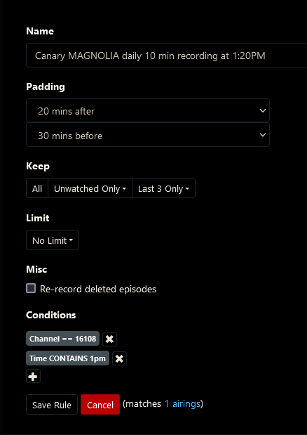

I just now changed the passes from a series pass to channel == and time contains 1pm, but I don't think that will fix the problem.
Here's the scheduled job for the 1:40pm recording tomorrow. Not sure how the Serial works with these, as it is when it was scheduled 15 minutes ago. It seems like the scheduler is looking at Airing.Time 1662408000 instead of the scheduled job start Time 1662410400.

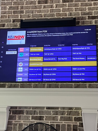

Ever since this was implemented I've noticed loads of placeholders in the guide data where there shouldn't be and never were before (see screenshot). Any idea why this is happening? Server is on the latest pre-release 2022.09.05.0346. Source is an M3U that combines output from my HDHR and SAT>IP tuners. Guide data is manually mapped data directly from Channels (not XML).
Just recreated the problem on another server set to do the same thing, just different times.
I captured log info, scheduled jobs and dvr/programs after this mornings guide update.
3 recordings scheduled daily at 12:00, 12:20 and 12:40.
I waited until the 12:00 ten minute recording finished, then at 12:13:04 I created a new series pass for new episodes of The Andy Griffith Show (cause I knew there would be none) just to get the scheduler to run through my passes.
It cancelled the 12:20 and 12:40 scheduled recordings.
Here are the log entries from the daily guide update finishing until the scheduled jobs were cancelled.

The placeholders seem to have their times wrong this morning. I am observing this on IOS and Web admin.
I'm running the latest prerelease and seeing correct times on my three dvr servers using the placeholder EPG. But, mine haven't done their daily morning guide update yet.
I hadn't updated since yesterday morning so I may have been a release or two behind. However, I am seeing the same behavior on the latest build. Four hours fast.
